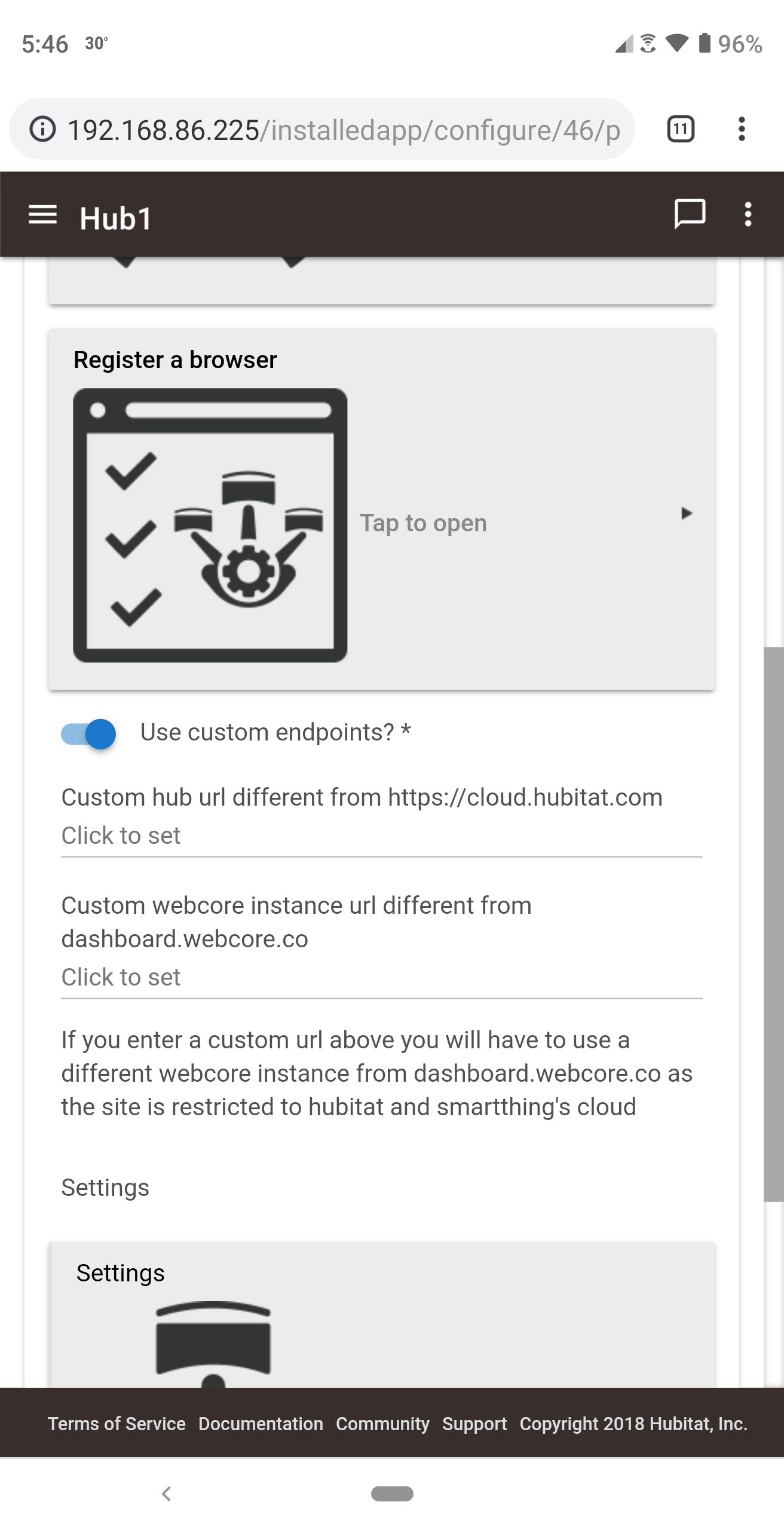

Ah, thanks for the screen shot! It was the use of the word 'dashboard' that had me confused. Endpoints. I was thinking the dashboards we configure to interact with the hubitat system (as oppose to where we code pistons)!.
I am not using custom endpoints. I am not running webCoRE on either a RPi or in a container simply using the default cloud.hubitat.com for piston management. Have I missed a required step somewhere?
FYI: I have deleted and restored HSM once or twice trying to see if that would resolve this. Obviously it did not.
I'm sorry, I still don't understand. You are contradicting yourself. What do you have entered in the first and second boxes?
They are blank.
Note in this screenshot I toggled the "use custom endpoints" to the on position just to show the fields. That slider is really off. This as it shows in the screenshot, cloud.hubitat.com is the endpoint.

Turn ok the custom endpoints. In the first box put in the IP address of your HE hub. In the second put in the IP address of dashboard server (where you have the webcore dashboard software installed).
