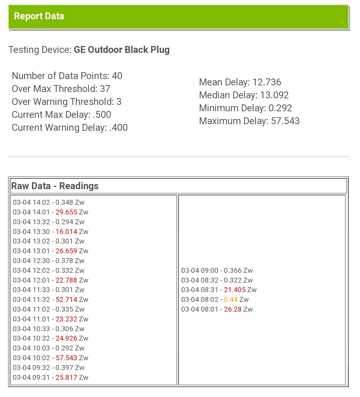

Here are my Z-Wave results.
@bobbyD Would you look at this, please? I submitted a ticket to support on Dec. 12 (#19637) that was referred to Engineering. My subsequent inquiries always get a response of "still in Engineering". The essence of the problem is that my Z-Wave devices periodically respond late (10-90 seconds) from the time the command is issued. Logs I sent affirm this. Now this report from Hub Watchdog provides further light. There is a consistent pattern of the first Z-Wave command takes a long time then the follow-up is executed in a timely manner. I hope there is something identifiable in this that you can fix because I currently cannot use any Z-Wave device in a timely automation.
Wow, there is definitely a distinct trend and issue under the hood on your hub. I hope support gets you some relief soon. The good news once they fix that issue, your 300-400ms response is very healthy and better than mine.
