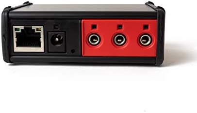

This supports telnet commands to the device above, works great.

I create dummy virtual switches in HE/ Alexa. I then say Alexa turn on ESPN. I hear the chime and then the Alexa NR integration determine the Sonos name I spoke to, then routes the request to the Global Cache device via IR command in the appropriate room. You will need a mapping subflow which converts ESPN to the actual channel number with loop when sending the IR command digits. I use this with AT&T TV streaming box, works great!
