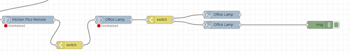

I did a reboot of Node-Red and left Hubitat online. Here is a screenshot of a flow sequence after teh reboot. The two device nodes shown are "uninitialized," as are all other device nodes in all other flows.
Yeah I agree. I will probably try the retries on unavailable nodes approach
For docker, the log is redirected to the output: docker logs <image_name>
Your issue is not related to the Uninitialized problem. When you start Node-RED, the device nodes are just not initialized and you need to wait before. The solution proposed for the other issue can also solve your case (because it will add synchronization between input and initialization)... BUT is only a side effect
IMO it's a load issue .. I can easily reproduce it if I restart a flow with 50 device nodes. I have often 1-2 nodes uninitialized because HE return 500
My guess is that if all requests was delay with 10-20 ms each, then there will be no error
This error is not obvious, but it's because hubitat doesn't return the device and the code just crash. It is the exact confirmation that I wanted, thank you
Also, I've fixed this error handler issue in the next version
