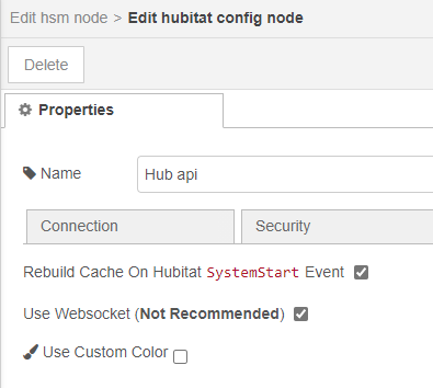

@william2 - how are you connecting to HE - webhook or websocket? Has the HSM ever worked or are you trying to get it to work now?
edit: I am not really using HSM because it doesn't quite fit my use-case.
@erktrek - I have has HSM setup and works fine with my sensors and button. However, this is the first time using the Node-Red integration with Hubitat, been using it with Home Assistant for several years. My setup is with webhook but based on your comment I switched it over to websocket and what do you know, its working although there is a warning in the config node (Not Recommended). I guess for the time being I'll create 2 configs, one for HSM and one for everything else. Thanks for the idea!

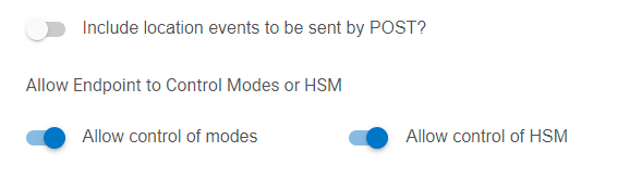

If yes: then be sure to enable the checkbox to Allow control of HSM events to be sent by MakerAPI

Or you can keep 2 config nodes :slight_smile:

Oh I think you need to enable "Include location events to be sent by POST"

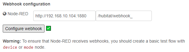

Just did this and it made no difference. I also went through the tips for debugging process as well, the only differences I saw was at the end of the webhook, in mine it adds an underline at the end in "webhook_" and no matter what I do to eliminate it Hubitat adds it back...
Edit: disregard the "webhook_" just learned that it mean that I have multiple configs, which in my case I do for now.
I confirm you need this checkbox enabled. Otherwise no HSM event will be sent (I'll update firstpost / readme Doc updated)
If you have two config nodes with only one Maker API instance, then events will sent event to only one config node (because your config nodes will have different endpoints (webhook, webhook_). So be sure to configure only one config node by Maker API instance

So I went back to basics and I think I found the problem. If you don't set the "Include location events to be sent by POST?" when you first create the API it won't work if you do it afterwards. I say this because I went back and made a new API making sure everything was on and sure enough the new one worked with everything. Put this one under user error :roll_eyes:
