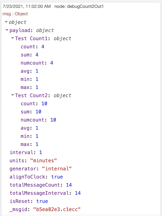

It counts messages per unit if payload is not numeric, but metrics per topic if payload is numeric.
Test flow below:
[{"id":"62fafc23.4b323c","type":"Metric per Topic","z":"46fabc1a.2d7c94","name":"Per Topic","units":"minutes","interval":"1","alignToClock":true,"generator":"internal","x":628.3333435058594,"y":959.0000839233398,"wires":[["917f4c16.973478"],["4f219f72.4d6968"]]},{"id":"a4070ce9.6b226","type":"inject","z":"46fabc1a.2d7c94","name":"Count 2","props":[{"p":"payload.att1","v":"one","vt":"str"},{"p":"payload.att2","v":"two","vt":"str"},{"p":"payload.att3","v":"three","vt":"str"},{"p":"topic","vt":"str"}],"repeat":"","crontab":"","once":false,"onceDelay":0.1,"topic":"Test Count2","x":265.3333435058594,"y":959.6666870117188,"wires":[["a01e964f.2632c"]]},{"id":"60e04fd1.764a4","type":"Metric per Topic","z":"46fabc1a.2d7c94","name":"Per Message","units":"minutes","interval":"1","alignToClock":true,"generator":"internal","x":601.6666259765625,"y":867.6666870117188,"wires":[["17131011.f1c19"],["7b1e9d01.7289e4"]]},{"id":"a01e964f.2632c","type":"change","z":"46fabc1a.2d7c94","name":"","rules":[{"t":"delete","p":"payload","pt":"msg"},{"t":"set","p":"payload","pt":"msg","to":"1","tot":"num"}],"action":"","property":"","from":"","to":"","reg":false,"x":463.33331298828125,"y":958.0000610351562,"wires":[["62fafc23.4b323c"]]},{"id":"d216576b.3e2dc","type":"inject","z":"46fabc1a.2d7c94","name":"Count 1","props":[{"p":"payload.att1","v":"one","vt":"str"},{"p":"payload.att2","v":"two","vt":"str"},{"p":"payload.att3","v":"three","vt":"str"},{"p":"topic","vt":"str"}],"repeat":"","crontab":"","once":false,"onceDelay":0.1,"topic":"Test Count1","x":275.6666564941406,"y":833.6667098999023,"wires":[["60e04fd1.764a4","a01e964f.2632c"]]},{"id":"17131011.f1c19","type":"debug","z":"46fabc1a.2d7c94","name":"debugCount1Out1","active":true,"tosidebar":true,"console":false,"tostatus":false,"complete":"true","targetType":"full","statusVal":"","statusType":"auto","x":823.6665954589844,"y":838.6667098999023,"wires":[]},{"id":"7b1e9d01.7289e4","type":"debug","z":"46fabc1a.2d7c94","name":"debugCount1Out2","active":false,"tosidebar":true,"console":false,"tostatus":false,"complete":"true","targetType":"full","statusVal":"","statusType":"auto","x":824.6665954589844,"y":891.6667098999023,"wires":[]},{"id":"917f4c16.973478","type":"debug","z":"46fabc1a.2d7c94","name":"debugCount2Out1","active":true,"tosidebar":true,"console":false,"tostatus":false,"complete":"true","targetType":"full","statusVal":"","statusType":"auto","x":825.6665954589844,"y":928.6667098999023,"wires":[]},{"id":"4f219f72.4d6968","type":"debug","z":"46fabc1a.2d7c94","name":"debugCount2Out2","active":false,"tosidebar":true,"console":false,"tostatus":false,"complete":"true","targetType":"full","statusVal":"","statusType":"auto","x":828.6665954589844,"y":983.6667098999023,"wires":[]}]

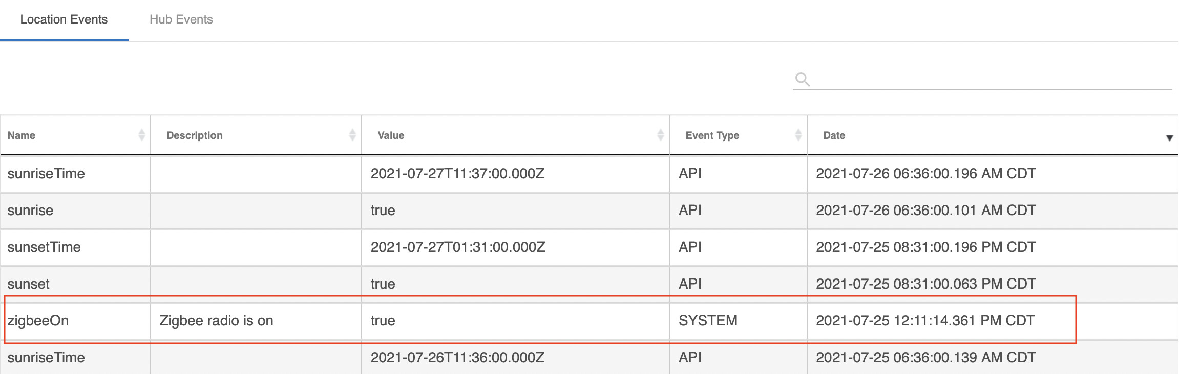

I am trying to have an automation based on when HE is restarted (NOT rebooted - using http://HUB_IP:8080/hub/reboot). Does anyone know of an event that is published to the HE node on restart? (NOTE: systemStart happens in both cases, so I cannot base it on that event)
Long story: I have a NR flow that receives HE log events via the unsupported websocket (logsocket). When the hub is rebooted, the websocket node remains connected. However, if HE is restarted, the websocket node shows that it is connected but does not receive any data. I have a weekly scheduled flow that reboots the hub and everything works fine. However, I have been having an issue where HE periodically restarts. I have not been able to nail down what is causing this - logs are clean, system resource usage does not appear to be abnormal etc. Currently, I am monitoring the log data and if the last entry was received > 90 minutes ago, I get an alert and have a NR flow that I can kick of manually that restarts the NR flows (and reconnects the WS node). I would like to automate this process hence the need to figure out an event that happens only on restarts and not reboot.
@fblackburn @erktrek @aaiyar - any ideas on this?
EDIT: I have seen the zigbeeOn event in the HE location system events log - this looks like it happens only when the HE is restarted as I don't see this entry when the weekly reboot happens but I don't know if the HE location node sees this (don't want to "test" it as I have only 1 hub :frowning:)

Hmmmm... @rakeshg One way would be to create a reboot subflow with 2 sequences.. first sequence sends a reboot and sets a variable (and would be triggered by the input). The second sequence waits for a systemStart and when it occurs checks to see if the variable has been set - if so you know it's been told to reboot. If not you know it's a hub crash. Could have 2 outputs one going to manual reboot, the other going to inadvertent reboot..
Or something like that...
edit: you don't really need a subflow for that, just 2 sequences and use a global variable. My over-engineering at work again... on the other hand if you are having the hub reboot in various flows then maybe a subflow would be okay.

I was just thinking the same and then saw your edit! I’m going to mod my existing flow to add the GV and then reset it from the systemStart event flows. If it is not set, then do the NR flow restart… sounds pretty straightforward - thanks for the idea!
One difference between reboot (Linux reboot) and restart (JVM and platform restart) is that during a reboot the hub stops responding to pings momentarily until the Ethernet interface is brought up and tcp/ip stack is loaded.
So, if you use a ping node in conjunction with the systemStart location event, you can distinguish between reboot and restart.
Thanks for the suggestion. It was simpler to use @erktrek 's suggestion and use a GV to distinguish between scheduled vs random restart events. As it turns out, I was able to use use a couple of change and switch nodes and plug them into existing flows and hopefully it all works :crossed_fingers:t3:
