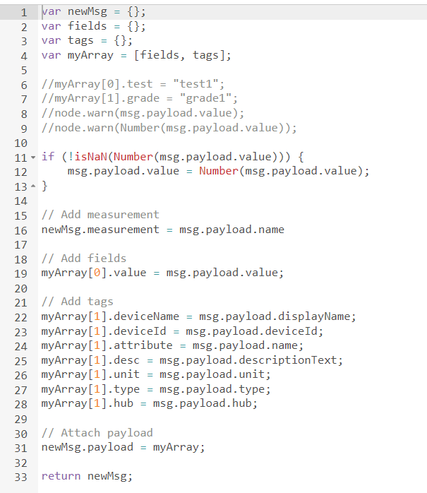

Anyone have an idea what is causing this error or how to fix it? It looks like it's happening on power node for influxdb. It seems to have appeared after the recent Hubitat platform updates as I've had no other changes for weeks.
node
I'm guessing something in this function node to get the data into influxdb no longer works with the recent hub update?
As it's the only thing in the sequence between the devices sending the data and the node going into influxdb.
node3
No idea what is happening but take a look at this link:
Thanks for the pointer, I tried a few things with no success but don't really know what I'm doing. So I'll probably just not look at the debug errors until something starts causing a problem.
