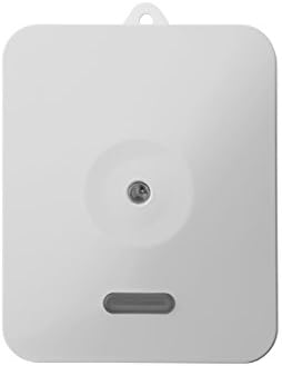

How about this thing?
There's a built-in Hubitat handler and the device has a "beep beep" sound that would work OK for opening a door.
It also has a repeating beep sound that beeps about once per second and that's what I use during my entry/exit delays.
It's more reliable then some of the other devices mentioned, but it's not perfect.
There's a dial that allows you to adjust the volume, but it doesn't make much of a difference and it changes the volume for both the siren and beeps.
