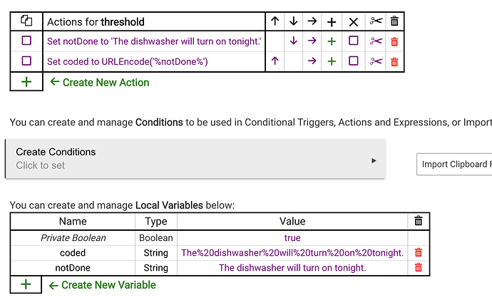

Ah ok. The Echo speaks seems a bit beyond me and the cost puts me off. I have Voice Monkey set up, but when I call the url from rule machine it changes the TTS from "The%20dishwasher%20will%20turn%20on%20tonight." to "Thenull20willnull20on%20tonight."
I have found a post that apparently solves the issue using a variable, but I really don't understand that. Any help?
You need to let the rule do the URL encoding for you. Like this:
Then you can use the coded variable in the url.
