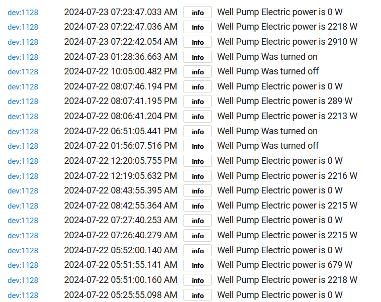

Let me be more clear:

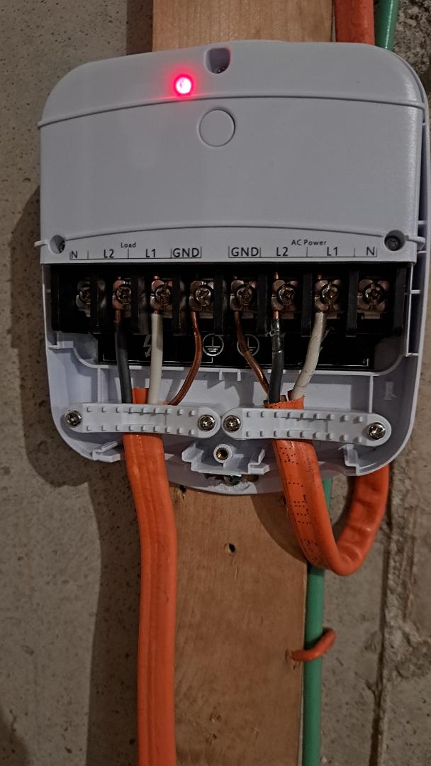

I use the Aeotec for whole house monitoring. It is at the breaker panel.
The Aeotec switch is 240v, with no neutral, like yours.
The power readings I post above were from that.
Here is a picture:

So you have an Aeotec clamp sensor like the ZW078 at the breaker for whole house energy monitoring. But in addition, you have an Aeotec switch for both energy monitoring of the pump and on/off. Gotcha.
But in your picture, there is no neutral. I thought the Aeotec switch need a neutral not for the load, but the switch itself operates on 120V.
Yes, I just took a second look and that is perfect, but I assumed it would need a neutral but that isn't mentioned. And taking a closer look at the Aeotec after seeing @velvetfoot photo, I'm wondering where I thought neutral was required. In fact, one of the reviews of the Aeotec says that unlike the description, no neutral required.

It works for both 120 and 240. Note in the picture above the 2nd terminal is marked L2 (N). L2 for 240, N for 120.

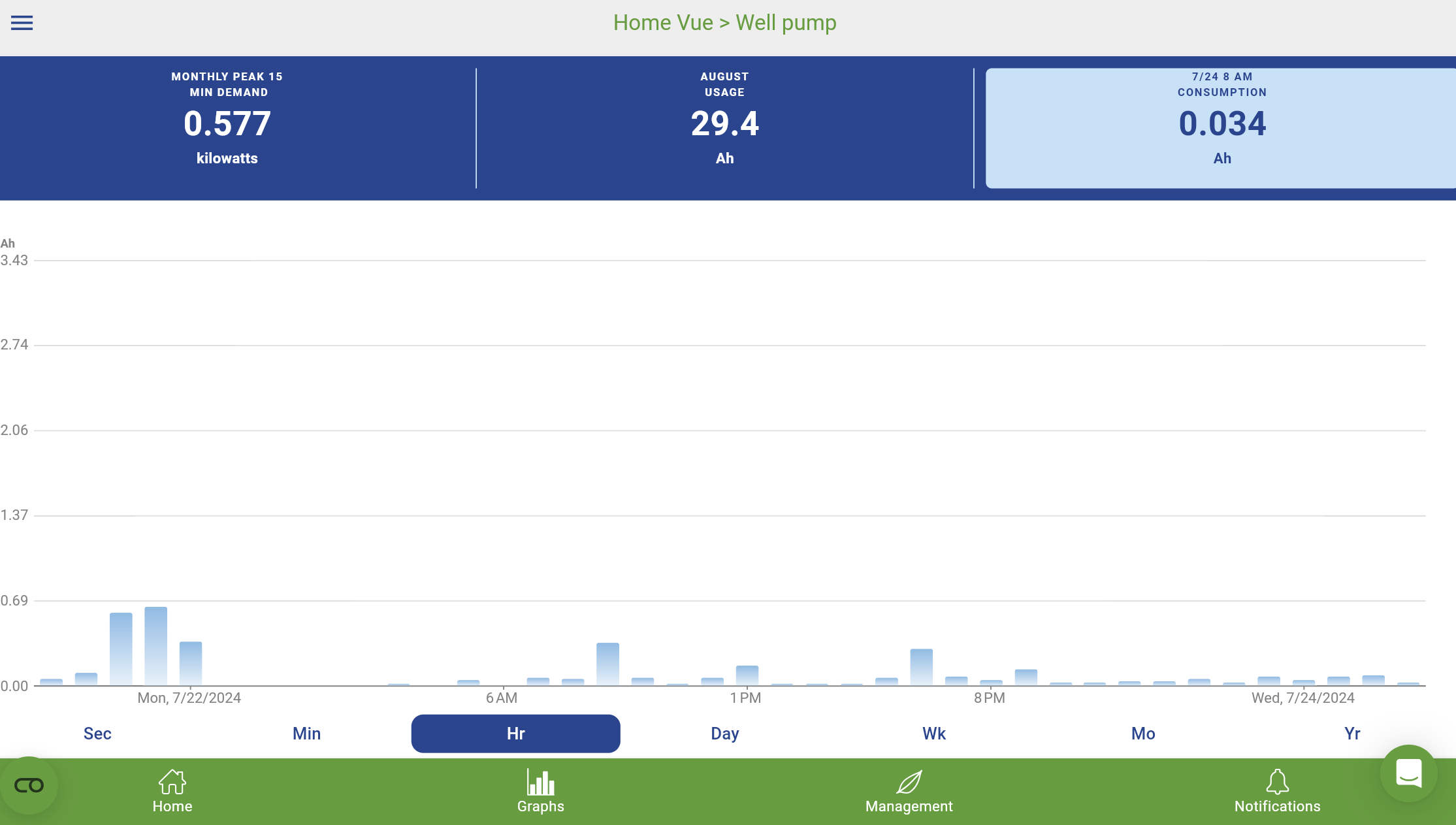

The Emporia Vue 2 with clamp on measuring devices will provide the information. Pick from, seconds, minutes, days , months. Unit of measurement amps, watts, dollars ..
