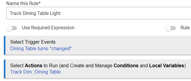

I had a problem with Google Home and my Leviton ZW6HD not staying in sync. Turn it on with the physical switch then tell Google Home to turn it off. GH would report the device being turned off but what I got was a NOP (no operation) instead. That was until I tried this.
It was a simple stand alone rule that allowed GH and my device to stay in sync.

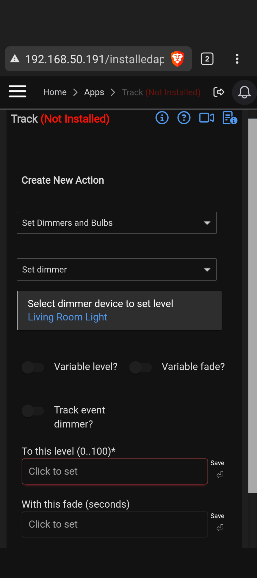

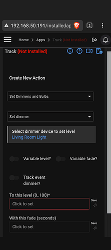

Thank you @croweflight, I tried to setup that using "Rule Machine", but I got stuck at the "Select Action to run", could not find "Track Dim" action. Is it may be "Adjust dimmer"?

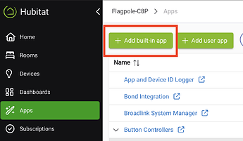

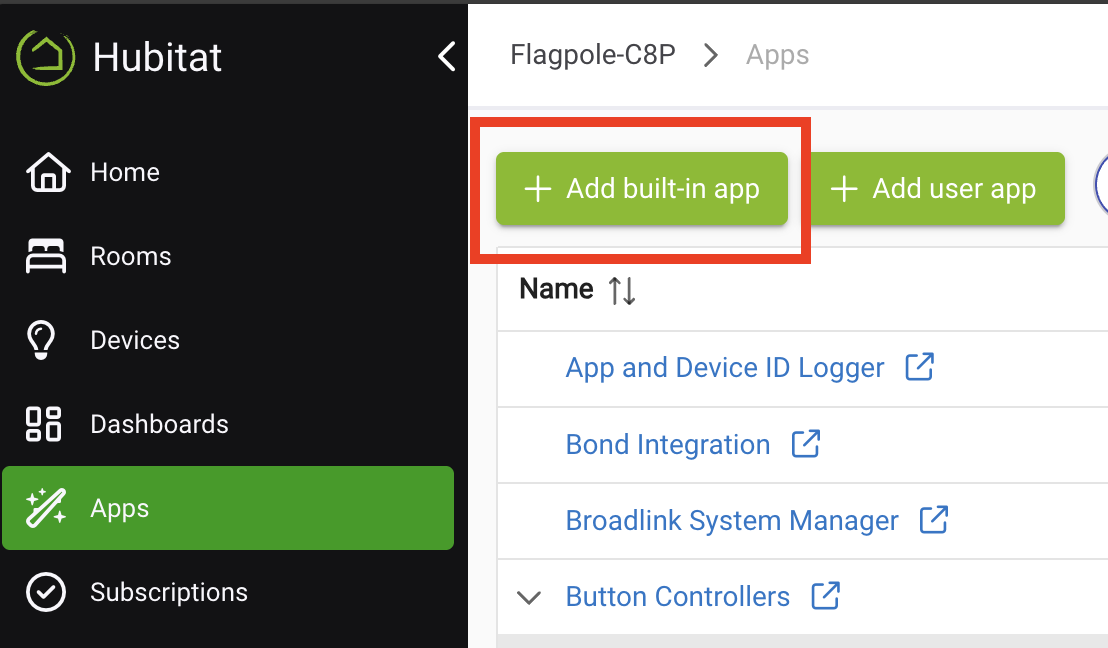

Where I can find native/stock verion of updater?
Go here, then select "Device Firmware Updater"
