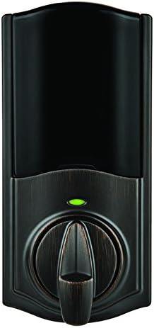

I have been looking all over for the Zigbee Kwikset. I can't find it anywhere. Can I buy the Amazon version and just pair it to the hub?
I checked out the page for the Amazon Key Edition. It doesn't actually say Zigbee on there anywhere. HOWEVER, there are some reviews where they say you don't actually have to have the Amazon Cloud Cam, and that they paired it to either an Echo Plus or a ST hub. That tells me that it's actually the same zigbee lock, and the "Amazon Key Edition" just means they are including directions that push people in the direction of pairing it to other Amazon devices.
So I think it would be safe to buy this version and try out the zigbee card inside. Worst case, you get to take advantage of Amazon's generous return policies.
yep. That's what I was thinking. Thanks!

This is more of a Z-Wave note, but since it was spurred by a Zigbee conversion, I thought I'd add to this thread. I recently bought an Amazon lock to convert one of my 910s from Z-Wave to Zigbee. That process was seamless, as documented here, just swap the cards. Special thanks to all who have contributed to this thread, especially the note to grab a used unit from AMZN to harvest the Zigbee card from. ($32 for me!)
Somewhere in the process of moving all of my HE "stuff" from the old device to the new, it dawned on me: The actual Convert hardware makes a great "portable" mothership for the Z-Wave card. Pop a Z-Wave card into the Convert hardware, and you now have an easy method to move the Z-Wave card close to the hub for secure pairing, then pop the card back into the 'real' lock already mounted on the door for use. If I had known about the Convert unit when I originally installed my locks, I would have gladly paid the $32 for the convenience.

I used this Amazon lock for my Zigbee card donors. As I mentioned above, this makes a nice 'carrier' unit for the old/other card. I would leave my HE unit as-it-was, physically swap the cards in the door unit, add the Zigbee card on-the-door, (ETA: swap rules, dashboards, LCM, etc. over to the new device,) then use the convert shell to remove the old Z-Wave module.
I tried to buy in the mid-to-high $30 range, and only from Amazon Warehouse. Sometimes the price does bounce around a bit. I had to wait on 1 or 2 of my locks to find the 'right' time to buy. (And for some reason the venetian bronze finish was always cheaper for me. Of course, it doesn't matter, but I thought that was interesting. I suppose more of those are being returned.)
