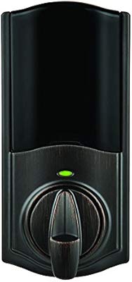

The reliability disparity with these two modules is incredible. The converted zigbee lock is now super reliable!
I agree. I was skeptical.... But it was REALLY worth doing. And since I found enough modules used, it was dramatically cheaper than buying new locks.

If anyone is still looking, they are on sale for $51.98 right now on Amazon new. Used are about $45. Mine have been flawless since i switched them out.
New is now down to $43.37. I just switched one of my zwave+ kwiksets to Zigbee using the module from a kwikset convert. Works perfectly now. Highly recommended conversion.
Can I use the zigbee module from this lock to convert my Kwikset 916 Z-Wave lock? This one has the touch screen on one side. Also, how do you remove the radio module from the inside lock portion? Thanks
Should work. Everything 910 and newer use the same modules.
I bought a random zigbee module from eBay and it worked in my 916. For eBay ones, you just have to be careful to not get a control4 module - sometimes they are listed as zigbee modules and they are definitely NOT compatible with Hubitat.
Yup it Will work in the 916. The radio board is right next to the battery pack. Pull out the battery and then the z-wave board slides out easy. The signed one goes in in its place.
