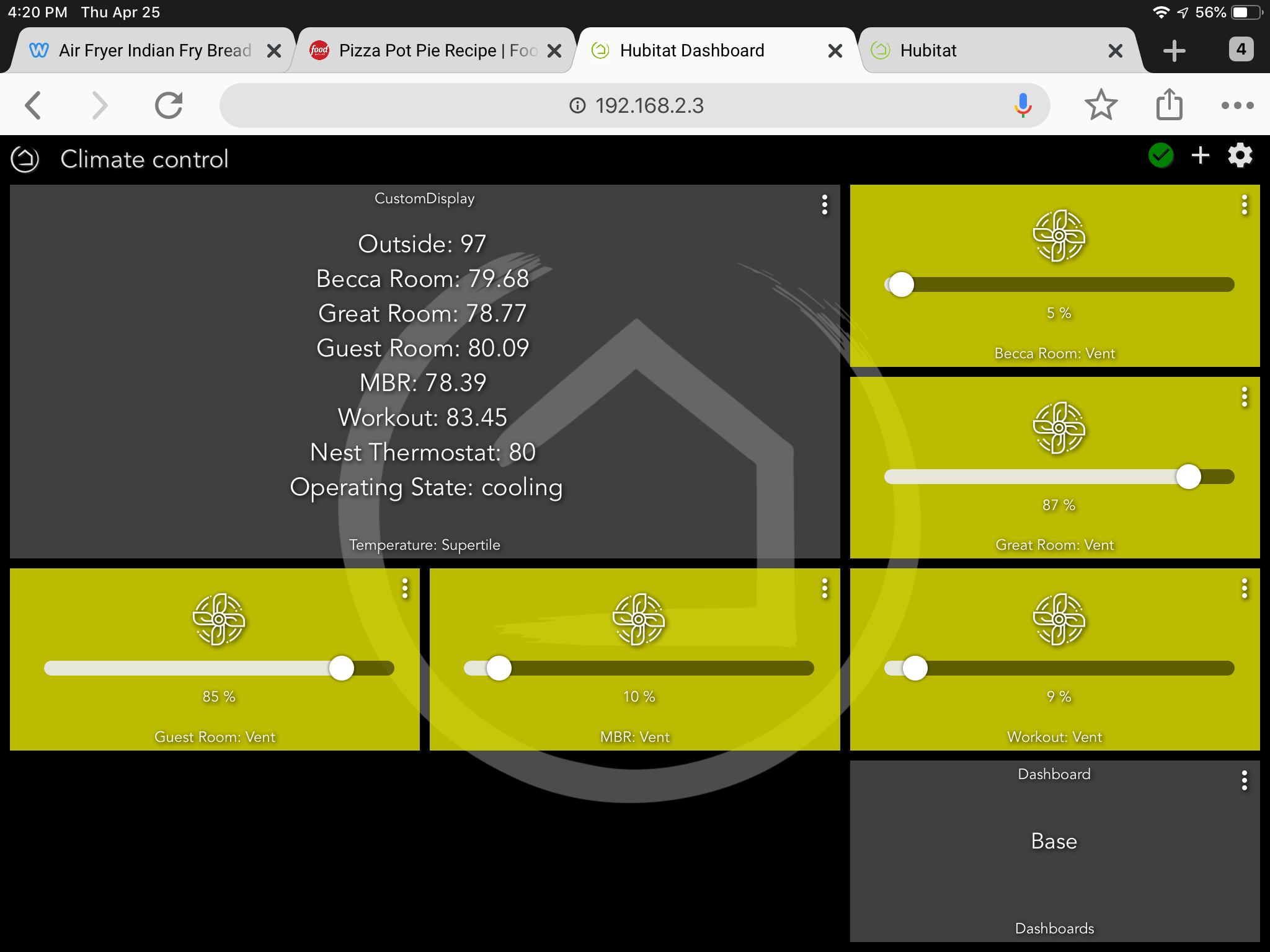

Installing a dashboard item:
Select the tile device, attribute and then select KeenectData under the attribute.
