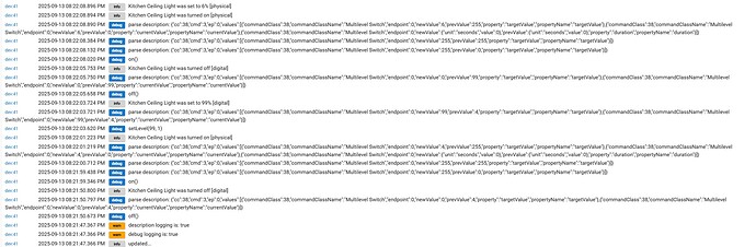

Long time z-wave user, first time hubitat user. All of my devices are set up, apps are running, but any time I adjust my lights via google integration by saying "turn XX light on" or via hubitat devices page, it always sets my lights to 4% brightness. I can't figure it out, but when i toggle "on" or say on via google, i'd like the light to turn to 100% (0r 99%) brightness.
Thanks! log below.
info
Kitchen Ceiling Light was turned on
info
Kitchen Ceiling Light was set to 4
debug
parse:{"cc":38,"cmd":3,"ep":0,"values":[{"commandClass":38,"commandClassName":"Multilevel Switch","endpoint":0,"newValue":4,"prevValue":4,"property":"targetValue","propertyName":"targetValue"},{"commandClass":38,"commandClassName":"Multilevel Switch","endpoint":0,"newValue":{"unit":"seconds","value":0},"prevValue":{"unit":"seconds","value":0},"property":"duration","propertyName":"duration"},{"commandClass":38,"commandClassName":"Multilevel Switch","endpoint":0,"newValue":4,"prevValue":1,"property":"currentValue","propertyName":"currentValue"}]}

Thanks for the tips. I joined the owners group, and read through all of the z-wave help guides and troubleshooting, but I am still not seeing how to solve this. I didn't see how I am supposed to post in a different group/thread, so I apologize if I need to be doing that...
Essentially, If I click the switch to turn the light on, if I turn it on via the devices page in Hubitat, or if I turn it on with Google using my voice, it always goes to level 4. I have tried setting it to 99, turning it off, and turning it back on.... for some reason it always goes back to 4. This time it actually went to 6 instead. I am lost....

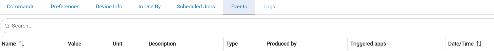

What do the device events show?

It's a GE/Jasco Z-wave plus switch, not sure exactly what specific model number though. I did not check device events, they just show command called ((off)) and ((on)) when I was toggling. Via digital (Google) physical and command.
It is with the Google standard integration through the "works with Google" page.
