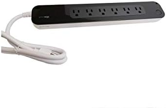

Great deal on these if you need them:
The eBay auction is supposedly for a 2-pack of the 6-plug ones, but the slickdeal poster received 2 boxes, each containing 2 of the 6-plugs and 2 single plugs.
I'm skipping it since all my devices are Z-wave Plus and these guys aren't. But the price is awesome, even if you only get 1 box.
I wouldn’t do it.. It’s non-plus z-wave and will act as repeaters at the slower rate of 40kbps
Is it possible to turn off their repeating functions so it doesn't slow down the mesh? I don't need it as a repeater but need to buy new power strips and this would be nice to have (although the original deal is dead now)

On second thoughts, I'm beginning to think this is worth it. It'd be at the opposite end of the apartment from my other zwave devices with the hub in the middle so I won't expect any of my zwave devices to go through it. For the price, it's much cheaper than the zen power strip and since I also need a power strip, might as well go with this. Worst case (if it's affecting my mesh), I'd either unpair it from the hub and use it as a regular power strip or add it to ST and use hubconnect...
I had to the the same thing. Working great on the 2 I bought from monoprice.
Thx. Just ordered one
Ditto. Can't go wrong for $19.99!
I recently moved over from Wink and had to give up my 8 Quirky Genius strips. Looking for an alternative and came across these for 20 bucks on Amazon. Ordered one and set it up without issues using the drivers provided here. Just ordered two more. With six controllable outlets I have to think of new ways to use them. The people here are the main reason I wish I switched from Wink earlier.
