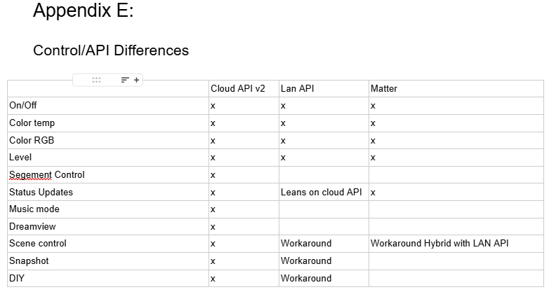

It really is about limiting the use of the cloud API and hitting the Rate Limit. There may be some performance benifit as well. One thing to consider is if you have good wifi and are able to use MATTER then the Matter driver may be a better choice than the LAN API. Here is the table from the documentation that talks about the differences

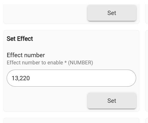

I have this set up and working well. I can set effects from the device driver using the effect number. However I'm trying to do the same from an automation.

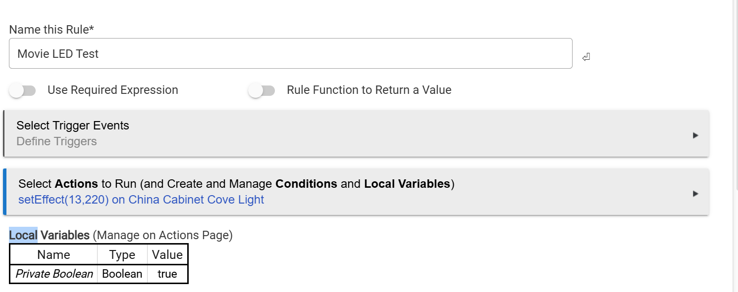

I tried using RM to set an effect using a custom action - I was able to find the command to set an effect number - but it doesn't seem to do anything when I run the rule.
This works in the device:
This does not work in Rule Machine:
Is there something I'm missing?
Also, the driver does not seem to pull any snapshots. That area remains empty after i load scenes. Is that expected?
Can you remove the , and let me know if that does it.
As far as snapshots go, that is likely because of how snapshots are retreived. Please go into the integration app and open the "Standard Device Setup" menu. That should retrieve the latest device info from the Govee Cloud and that contains Snapshot data. Once that is done go back to the device and have it reload it's scenes. They should appear.

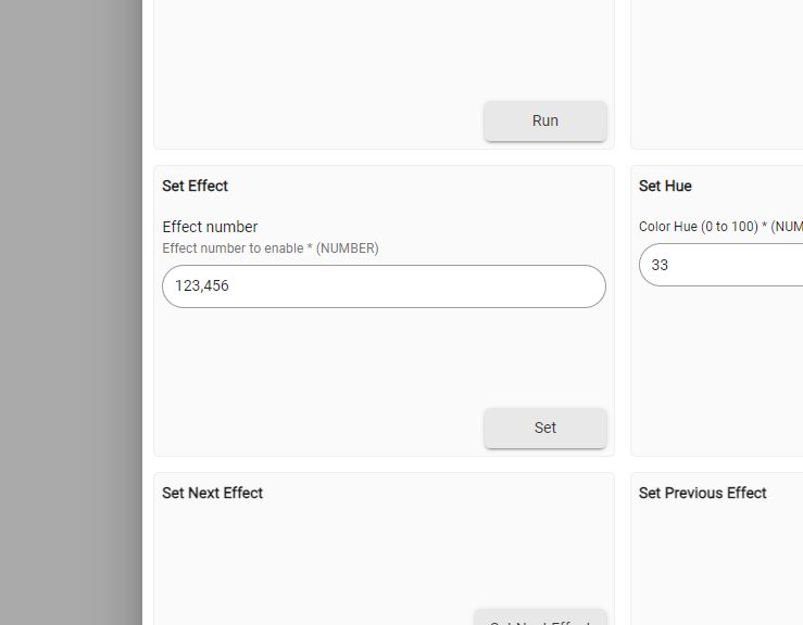

The field is entering the comma automatically. I just entered 1-2-3-4-5-6 (no comma) and this is what is in the field. I noticed that the other day but kept forgetting to post about it.
Yup - same...also forgot to post about this when I saw it recently. :slight_smile:

This example uses a string rather than a number for the parameter. I just tried that and it works.
So even though it's a number in the Device details effects field, in RM, you need to enter it as a string.
I resolved the first issue by using a string in RM rather than a number. However going into Standard Device Setup didn't retrieve any snapshots. I tried hitting Load Scenes in the device, as well as Initialize and Refresh - and refreshing the page. None of that pulled in any Snapshots.
