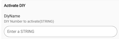

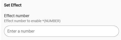

I believe Govee built-in effects and DIY (community) effects require two different commands to run:
  • Built-in: setEffect > Number
  • DIY/Community: activateDIY > String
Built-in scene:
DIY scene
I think this app only handles built-in scenes, tried a DIY scene and it didn't play.
Would it be possible to add the ability to handle DIY scenes as well? Mayve via two sections in the input file w/appropriate headers, or an identifier on each scene that would ID it as built-in or DIY?

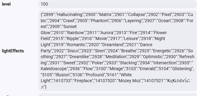

After talking with @JDC a bit more i made a few adjustments based on his input. One of which was i now have as part of the scene state value update processes a step to populate the lightEffect attribute with a json that is the combination of the DIY and provided scenes. I am not sure how much of a help that will be but it is now there. There will still be the seteffect and ActivateDIY commands, but now you can identify the name easily.
I am not clear on the requirements for the lighteffect json format. I would love to split up the DIY and the Standard scenes but not sure if that will go along with how that attribute is suppose to work.
Here is the example of it populated with Cloud API data including a few DIY Scenes.

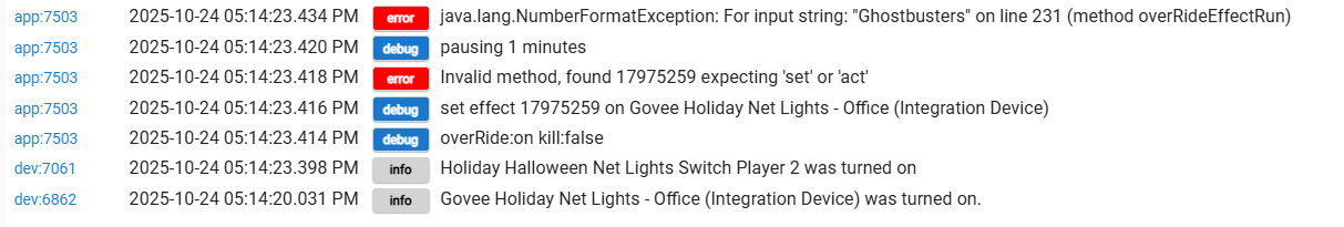

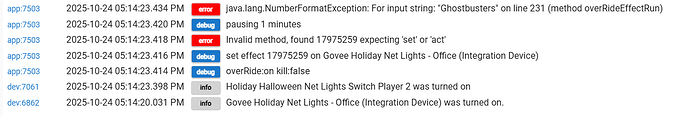

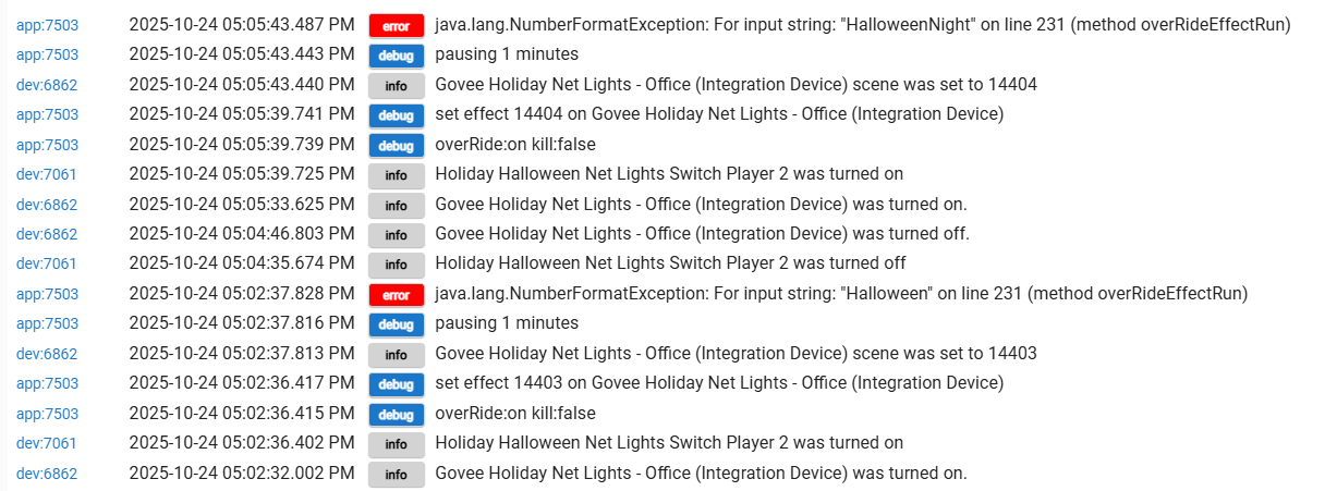

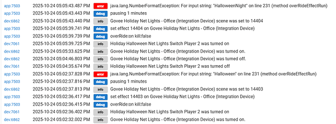

Somehow I'm having some strange errors, and also think I found a typo in the new Player app...fixing it didn't seem to help my issues.
This is the typo: activevateDIY was in the code instead of activateDIY. I assumed the correct spelling was intended. Occured in two lines that I could find, I believe 185 and 223. I corrected them to activateDIY, but didn't help...couple of runs below:

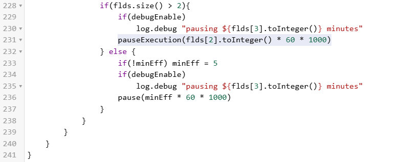

Line 231 where error occurs:
I'm using the file format below: I'm actually a little confused about whether I should use setEffect/activateDIY, or set and act in the txt file. 'Set' seems to work, but when I use 'act' the player doesn't seem to start up properly and just hangs:
set:14403:Halloween:1
set:14404:HalloweenNight:1
set:14405:BouncingPumpkin:1
set:14406:Pumpkin:1
set:12532:JackoLantern:1
set:18515:HalloweenPumpkin:1
set:12528:Aurora:1
set:12531:Graveyard:1
act:17975259:Ghostbusters:1
act:18009786:Spider:1
act:18011499:WelcomeGreatPumpkin2:1
flds[2] should be flds[3] … Pushed up a fix.
