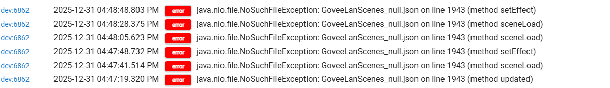

Will check or errors.

Can you check your logs and let me know if any error occured. I am working on the parser for for this new method.

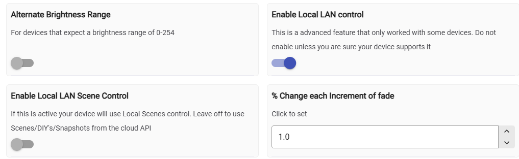

Flip the switch on "Enable Local Lan Scene Control" and then refresh your scenes. When that is off you are using the cloud to access scenes.
Yes - well, the scenes are in the cloud - so isn't that what I want?

Flipped the LAN setting switch and did the load/refresh an am getting errors...
