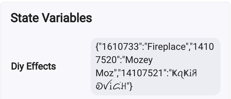

I think I may have found the issue, though I don't like it. I suspect if you go into the devices and look at the state variables for it you will still see a Diy Scene Options value with your DIY's listed next to it. That should have been removed and then changed to diy Effects as shown below.
When I started to test this myself I found that it wasn't right on my prod hub either and I couldn't find out why. I re ran the process multiple times to update the scenes and it just wasn't applying like the updated code libraries were not being applied. I fixed this by simply opening the driver code itself and clicking on save. That seems to have triggered the driver to recompile and collect the new code. The next attempt to update the DIY effects/scenes worked as expected and I got what you see above.
Please go ahead and try the same open under the developer page open the driver and just click on save. Then go back to the devices and click on "Scene Load" command and hopefully you will have the DIY Effects state variable to remove the error.

Confirmed driver now shows "DIY Effects" as desired/expected:
And it looks like my errors have disappeared (now on 2.4.0.144). :slight_smile:
I believe we can declare victory. :smiley: :smiley: Thank you very much!

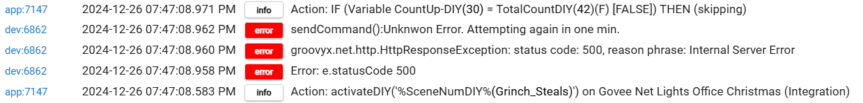

Oh man, shoot...just started up again.
You can multitask while baking bread.
Well that is either a rate limit issue, or Govee's api has gone down for the time being.
Ah, OK. I have been doing a lot of testing. Hmm...I'll take a look at my rule and see if I'm making unnecessary calls. I think you said I had a 10K limit/24 hours.
Assuming things reset at midnight, I'll be able to confirm tomorrow AM that it's a rate limit issue.
Thanks! :slight_smile:
Yep. The rate limit is one of those things they kind of screwed up big time with their new APi. I use to be able to keep track of it in the Smartapp, the new app broke that as it isn't include in the response anymore.
