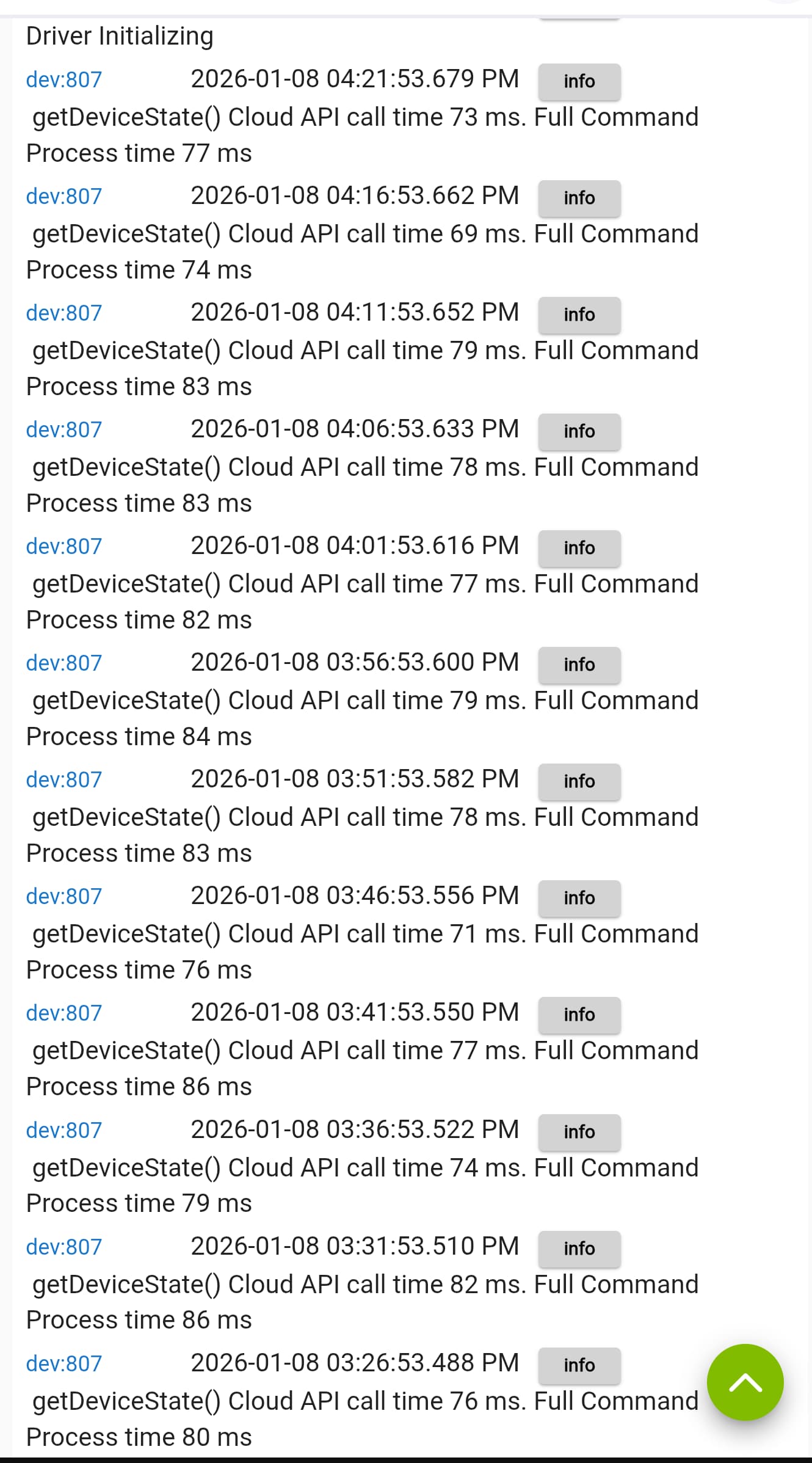

From the screen shot above It looks like you are using the Cloud API. So that means the devices are getting commands from the Govee Cloud. Even when you submit commands through hubitat, they get sent to the cloud and then come back to your device. Do you have any setup for Local Lan Control?

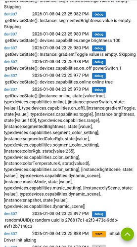

Pick one of the devices on hubitat and open up it's preferences page. Turn on Debug Logging and click on "Save and Close". If you have devices that have "Local LAN Control" turned on you may want to do the same for the "Govee Device Manager" device. If you set something to Info that was probably for the Govee Integragtion app. That probably won't give you anything. That logging would help for issues with Scene extraction or installing devices.
What you are looking for is basically a command submitted to change to that given state, or was a poll done to get the device status that had the new state without it being submitted from the Hub itself.

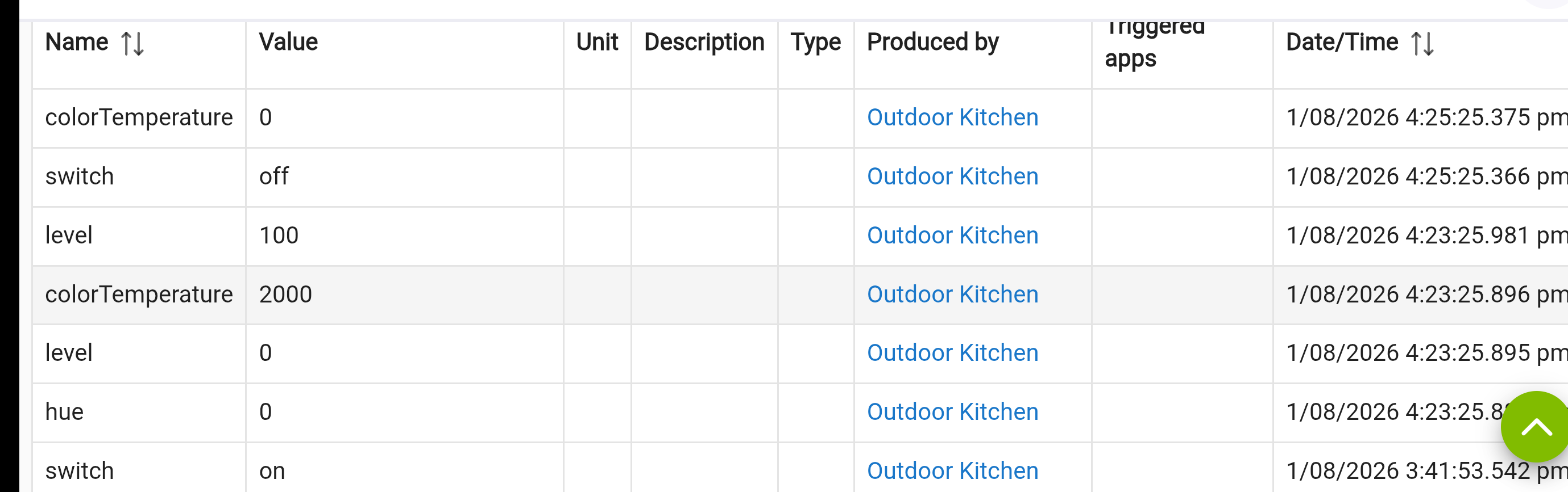

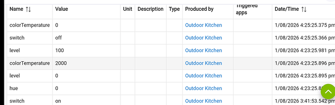

Any chance the info logs might be in your past logs? Filtering them by the Govee device might provide you with what you’re looking for. Alternatively, you can check the devices’ events to get a clue to what triggered the « on » event.

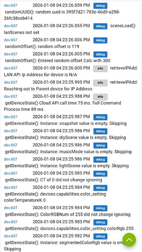

I need to be able to see the event that put in the on status which isn't there. I do see that after you updated the preference to enable debug logging the driver performed a getDeviceState() which gets the device current state and it did show it was on at that time. It didn't submit an event though because it was already in that state.
Now that debug logging is on we can get that information the next time it occurs

I had the same question as there was nowhere I was setting 50 from but it's in the events as coming from the driver in the morning which is odd.
