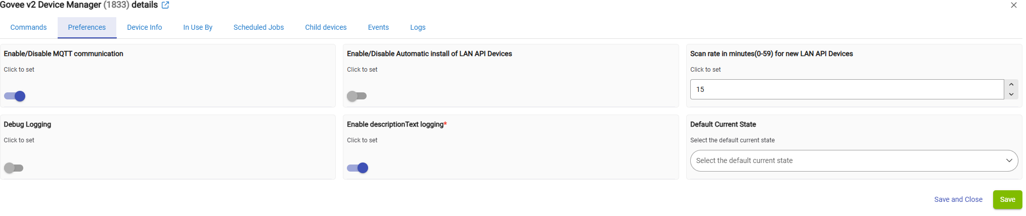

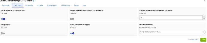

Open up the "Govee Device Manager". Click on the preferences tab. You should see something l ike what is below
Here you have a option to set the scan rate. It is in minutes though so that kind of kills my concern already.
Please turn on debug logging on that page and click save and Close. Go to the Live Logging page and capture just the logs for the "Govee Device Manager" and either post it here or DM me.

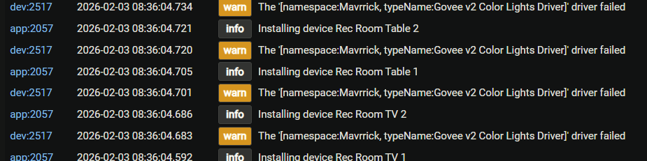

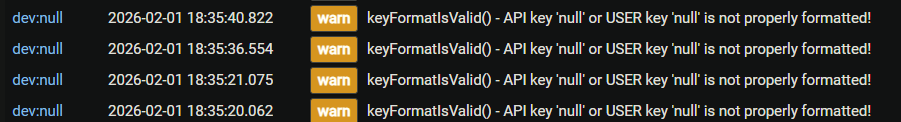

I have been getting these lately but I have no idea where they are coming from.
The times are odd like 10:30 and 18:30. None of my automations run here except lighting pistons.
I do have 4 Govee bulbs that I have been using for the last month and it seems there are 4 null log lines each time. The bulbs have been working fine though.

@dnickel
Do you use something like Maker API, Google home, or Something that talks to the hub from a external system via the cloud.

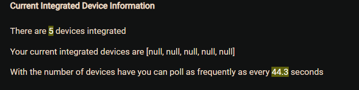

That is very strange. Seems like your integration has 4 devices that are partially setup somehow. Something isn't right. I would suggest you remove the 4 devices and the integration and start over. I don't know how you you would get a device that is null on that page.

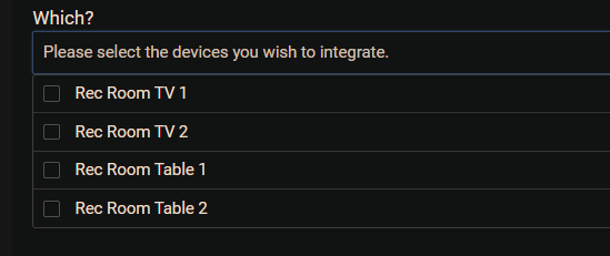

So those 4 Rec Room devices shouldn't be in the dropdown if they are integrated properly?
I'll reinstall if this is the case.

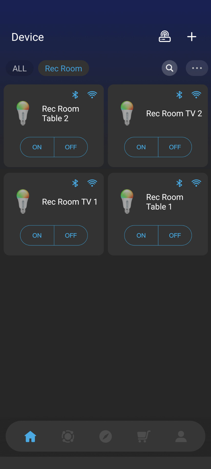

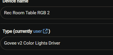

Quick observation. My bulbs don't have the same name in the Android App as they do in HE as I renamed them to a better naming convention after the fact.
Could this be it?

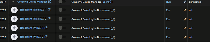

I have these working fine:
That shouldn't make a difference. Does the device list stilll show null in the Govee Integration app.
No, shows up fine in the app except with the original name.

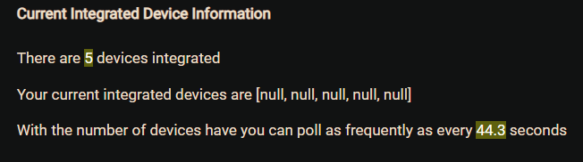

Sorry i ment on the Govee Integration v2 app like you showed above. It showed 5 devices but then showed all of their names as null
Yes strange. they all have a proper name as devices but null in that one line.
I'm guessing the 5th device is the Lan integration (which I have no devices)?

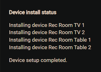

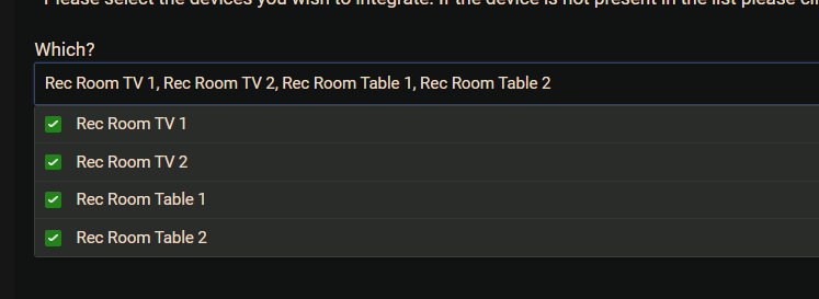

I did the Manual "add a device" and nothing seemed to change.
Still have my null friends but devices are fine in Device tab.

I have Debug on and I get quite a few of these
I will perform some additional testing as well. I don't expect that should happen.
Ok i have spent some time on/off trying to dig into this. I don't really have a good answer but there is no doubt something is off with your setup. Here are the observations
  1. Your devices are showing "null" for all 5 devices in the Govee Integration app.
    a. This shouldn't be possible first. That list is created by the system at run time. What it does is pull the child devices for the app and the "Govee Device Manager" and then displays the label there. That is pased during device creation process based on what is given by the Govee API.
    b. Once the device is created you can change the label in the device preferences. Even if you just blanked out the label and then only updated the Device Name then it would just be blank and not null based on my testing. You can see the example below
    876
  2. The "dev:null" in the log entries from your post 2012 are confusing as that should point to the device involved. The fact it says null indicates the device in question is corrupted in some way. Simply put it shouldn't be null ever. It would be interesting on those entries to place the mouce over the "warn" image and see what the URL is you are directed to.
  3. The errors you mentioned in your last message may not be a suprise considering the other issues. That could be expected, but not harmful, if the logic to that prevents already created devices from being submited to be created again failes for some reason. Considering the other strangeness you are seeing i wouldn't be suprised if that was the case.
By chance did you first install the built in Govee Integration and then just switch the devices to my drivers after they where already created? I am just trying to figure out what is unique about your setup becuase i can't seem to reproduce it. Also what hub version are you running?
