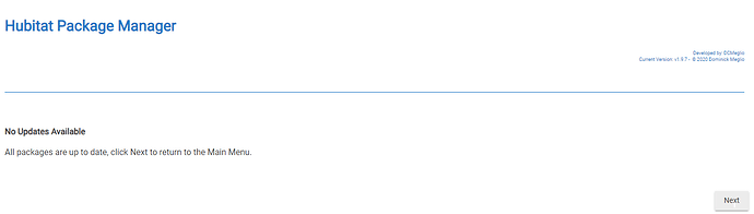

Can you verify you are running HPM 1.9.8 and try again. I just cleaned off one of my dev hubs and reinstall the integration completely with no issues.
I can't seem to find the version. This is the one that come in with the built in from my new C8 Pro.
The version for HPM is generall in the upper right corner of the ui when in the app.
Did you retry the install.
Ah found it. Thank you much.
Looks like the built in from the Hubitat is the older version. I just installed the one from the (HPM_Install2) but it is 1.9.7 version. On hubitat website it does not have instruction on 1.9.8 veresion?
There is no built in HPM.
If you have 1.9.7 just run an update (from within HPM) and it will update itself.
Use the option to perform a repair from HPM itself. That should get you on 1.9.8 then try the install again.
It worked. Thank you sir!!!.
