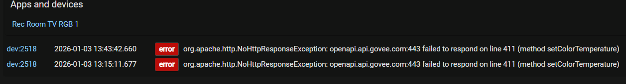

I get this randomly on the bulbs when I set CT.
Only one bulb out of the four but different each time; not the same bulb.
Did the error just start after the most recent updates?
That seems to indicate the Govee Cloud API is being slow to respond to you.
