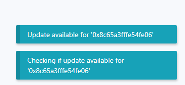

Funny, the 1.0.5 update is available first on Zigbee2MQTT, before Sonoff own hubs! :slight_smile:

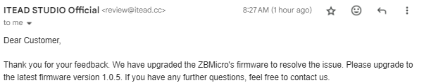

Now, I think that providing the OTA updates first for other home automation systems, not for Sonoff customers, is a smart strategy!
There was an unsuccessful firmware update for the Sonoff TRVZB thermostat a few months ago. It was the Z2M users who suffered from it, I think it was withdrawn later. But this OTA never reached Sonoff hubs customers!

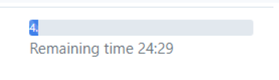

The OTA update was sucessful, paired back to my C-7.

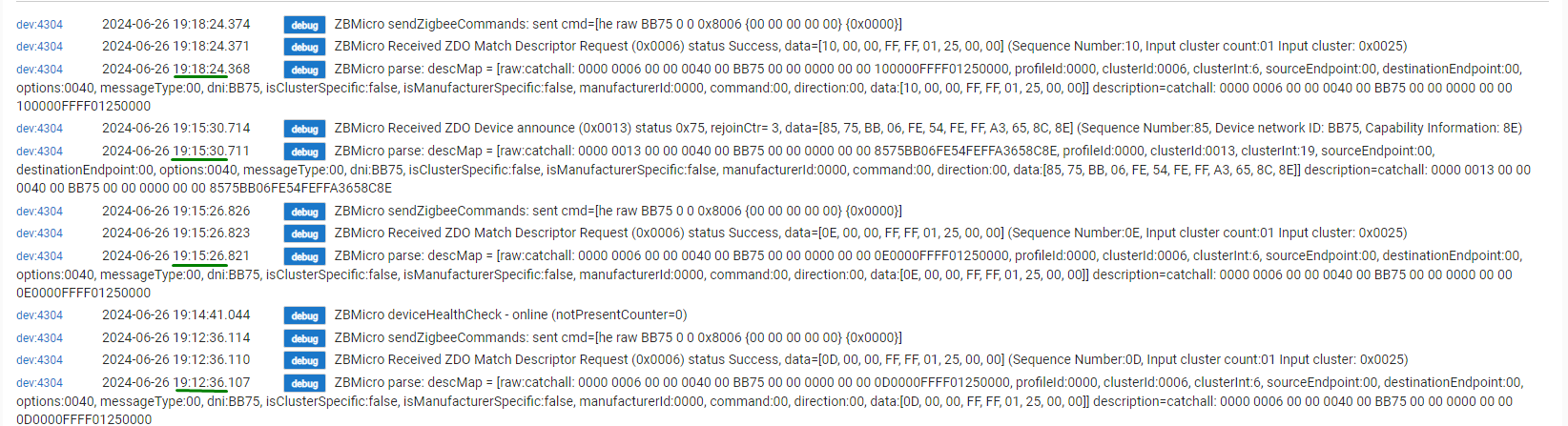

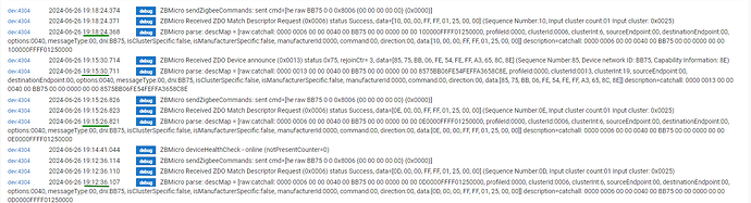

Now, the ZBMicro sends Zigbee messages (ZDO Match Descriptor Request) to the hub only once every 3 minutes (180 seconds).
Before, the request was sent every 15 seconds.
Now, with the 1.0.5 firmware update, ZBMicro is 12 times less chatty than before! :+1:

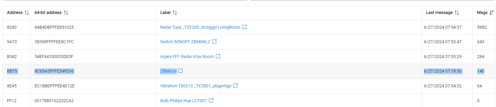

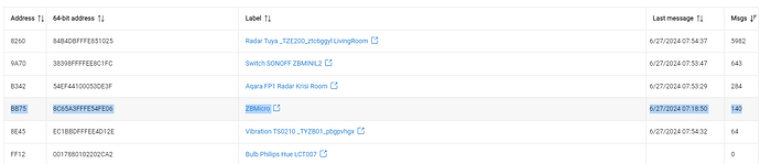

Here are the Zigbee stats 10 hours after rebooting a C-7 hub :
The ZBMicro 1.0.5 is 42 times less spammy compared to the Tuya mmWave radar.
