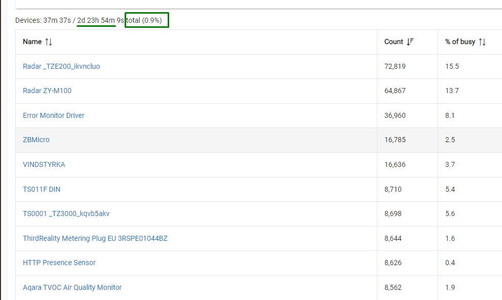

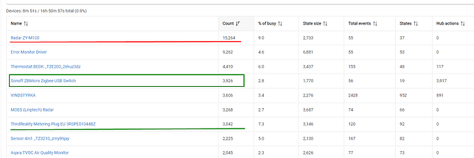

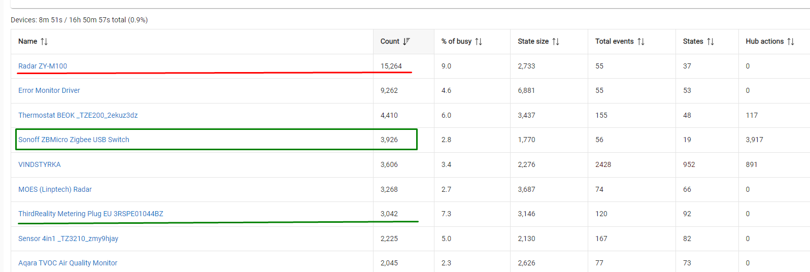

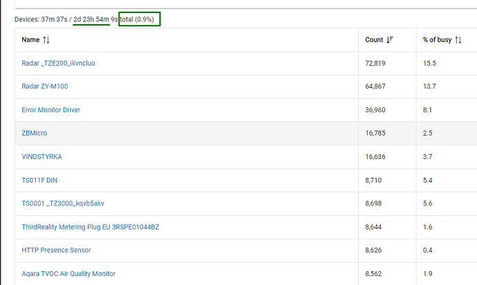

From another point of view - the ZBMicro is 4.3 times less chatty than the most spammy Tuya radar, and all these devices do not overload the hub - they consume only 0.9% of the hub CPU resources.

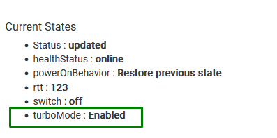

Using this driver it is possible to change the power-on behavior and to turn on the Zigbee radio high power (similar to Hubitat C-8 radio levels 4 / 16 )

It is comparable with the ThirdReality metering plug (I think the EU version is as chatty as the US model). For comparison - the infamous Tuya radar is 4 times more spammy.
