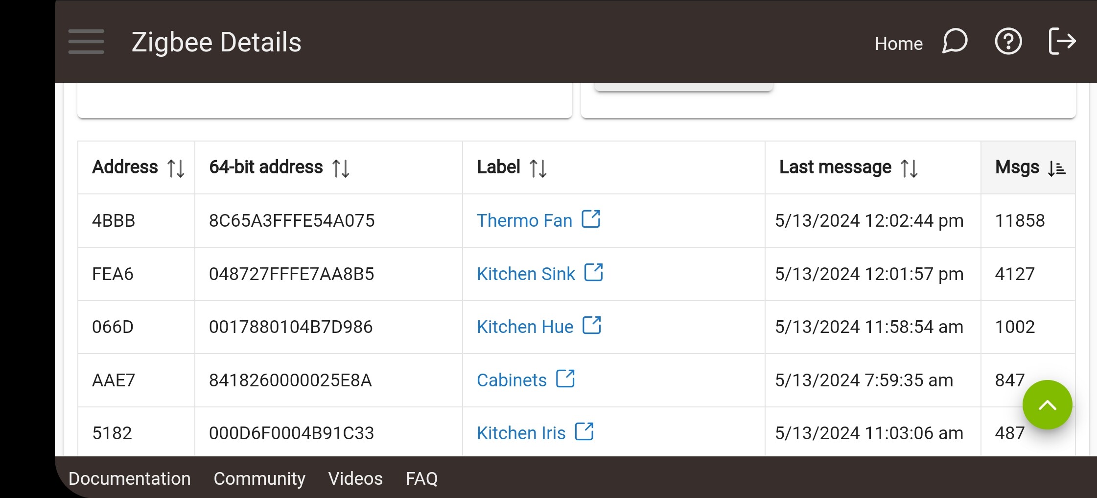

Update: Seems to be quite chatty. I've been watching the zigbee logs for this device and it's sending every 15 seconds. A lot of messages for 2 days(Thermo Fan).

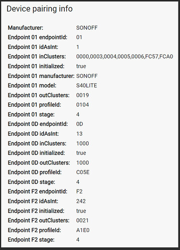

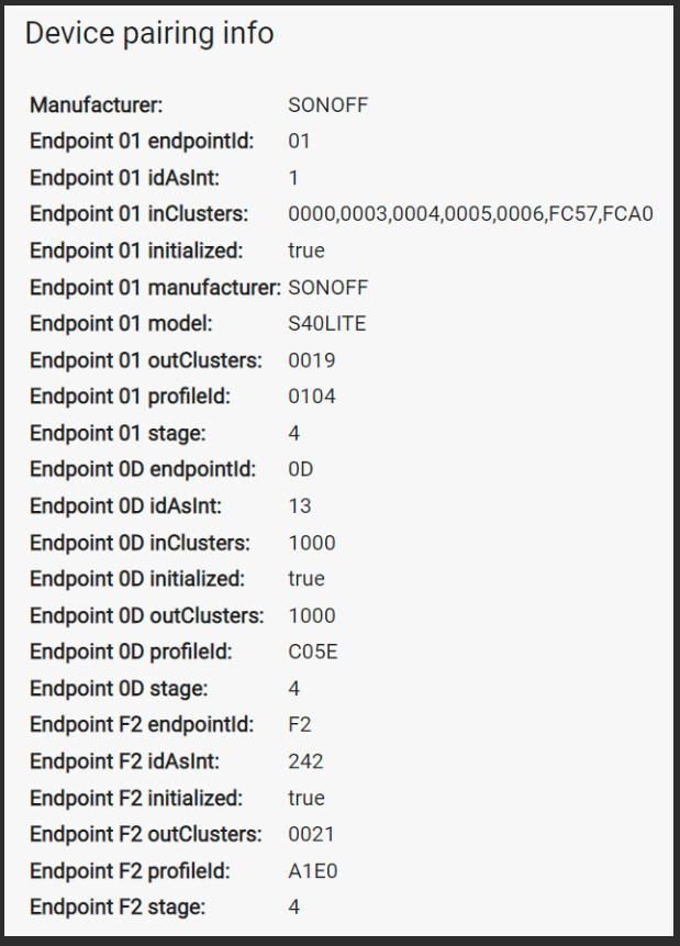

Sounds good, here's the file from my plug way back when I first included it.
‎S40ZBTPB Lite
SONOFF S40 Lite 15A Zigbee Smart Plug with ETL Certified, Works with SmartThings, and Amazon Echo Plus, Hub Needed for Amazon Alexa 2-Pack
S40ZBTPB Lite
‎S40 Lite ZB 2-Pack
https://sonoff.tech/product/smart-plug/s40-zb-lite/
Zigbee 3.0
Type B: 120V ~ 60Hz
Type B: 15A/1800W
MCU CC2652P
Manufacturer: SONOFF
Endpoint 01 endpointId: 01
Endpoint 01 idAsInt: 1
Endpoint 01 inClusters: 0000,0003,0004,0005,0006,FC57,FCA0
Endpoint 01 initialized: true
Endpoint 01 manufacturer: SONOFF
Endpoint 01 model: S40LITE
Endpoint 01 outClusters: 0019
Endpoint 01 profileId: 0104
Endpoint 01 stage: 4
Endpoint 0D endpointId: 0D
Endpoint 0D idAsInt: 13
Endpoint 0D inClusters: 1000
Endpoint 0D initialized: true
Endpoint 0D outClusters: 1000
Endpoint 0D profileId: C05E
Endpoint 0D stage: 4
Endpoint F2 endpointId: F2
Endpoint F2 idAsInt: 242
Endpoint F2 initialized: true
Endpoint F2 outClusters: 0021
Endpoint F2 profileId: A1E0
Endpoint F2 stage: 4
