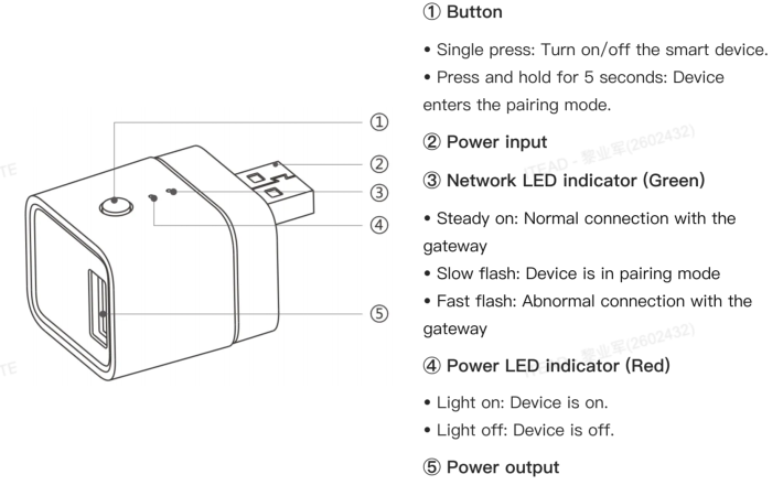

One caveat: the green Network LED is in a fast flash, which means the device isn't seeing something. But on/off are working as expected.

I'm wondering about the fast flash ("abnormal connection with the gateway"). I presume the device is expecting some specific message from the hub.

Like @jlv mentioned, the Network LED Indicator continues to 'Fast Flash'
