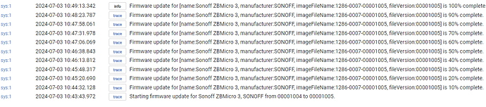

That's the way to start the update. You should get a pop-up asking you to proceed, and then you should see something like this in the logs. The actual device page won't show any progress.
Make sure you have the logs open -- it takes over 5 minutes.
(You should probably see a "Downloading" line in the log, too, but I'd already updated another ZBMicro so I assume the firmware file was cached on the hub)

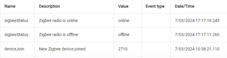

Darn - the ZBMicro with 1.0.5 is still causing havoc with my main C-7. It took just under 7 hours for it to cause the Zigbee radio to crash. That's much better than it did back in May , but it's still a bust for this device as far as I'm concerned.
I'm pulling it off my main C-7 and putting back on the idle one (where it hasn't caused an issue because it's the only device there).

Last night finally I was able to upgrade the firmware after a couple of tries.
The first time I noticed that the update process was running, the Log activity showed under ā€œHubā€ device increasing percentages every 10%, up to 90%, and then nothing happened.
After a while I restarted the upgrade option and this time it went all the way to 100% and finally upgraded to 1.0.5.
It took about a minute per 10% advances, totally lasting about 11 minutes.

One negatory so far...didn't solve the problems in this case:
