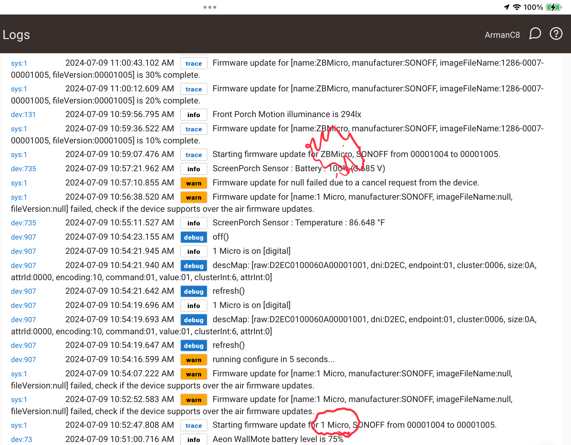

Finally got my ZMBicro firmware updated!
Didn’t realize the device needed to be named “ZBMicro” for the firmware file to be located.

I successfully updated the firmware on two, without ZBMicro in the label/name. (I updated them from the Device driver, not the Generic Zigbee Switch driver.)
So sounds like a timing coincidence w/@TArman's success, then. Thanks for that info.
I should add that my initial attempt was to update the firmware from the Generic Zigbee Switch driver with a custom name (i.e. not ZBMicro), and it did not work. I changed to the Device driver with the same custom name, and this worked. I never tried to use the Generic Zigbee Switch driver with ZBMicro in the name.
The device name/label definitely has nothing to do with the OTA updates.

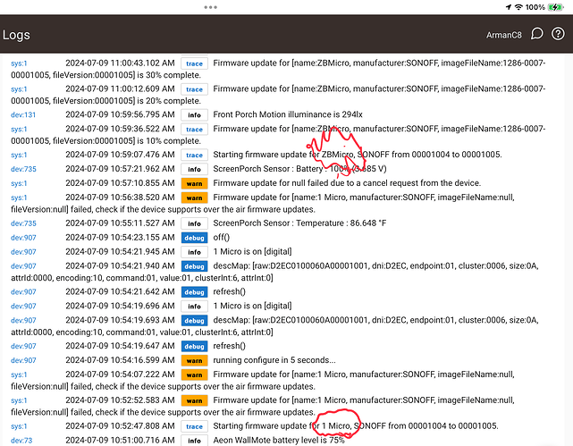

Interesting that with a different name “1 Micro” it failed 3 times.
Changed name and updated.
When we experience a correlation that seems significant, it can lead us to determine causation that really doesn't exist.
It's like when my wife blames me for her unhappiness after 30-odd years of marriage. Also clearly correlation, not causation. :rofl:
Beginning to wonder if the blank/space in the name “1 Micro” FUBAR’d it???
[I know, another correlation!]

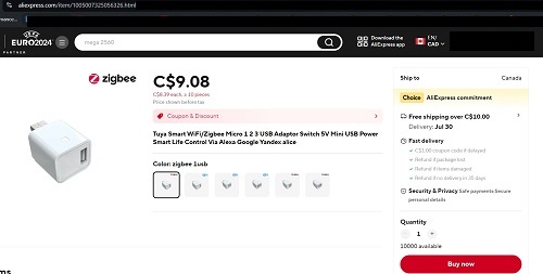

Yep, you can search from AliExpress web page for an item number - same way as when searching in Amazon for a product Id (ASIN).
Note, that some AliExpress products are region restricted and could not be visible in EU or in the US/CA. As an example - I do not see product 1005007325056326
Hmm, that's the one with "Choice Free shipping over C$10.00" for me.
Must be a supplier/warehouse choice that ships direct to Canada.
In the past I've had the AE website do some strange things to my presets when clicking on posted links (changes language/currency), so I try and avoid doing that as much as possible.

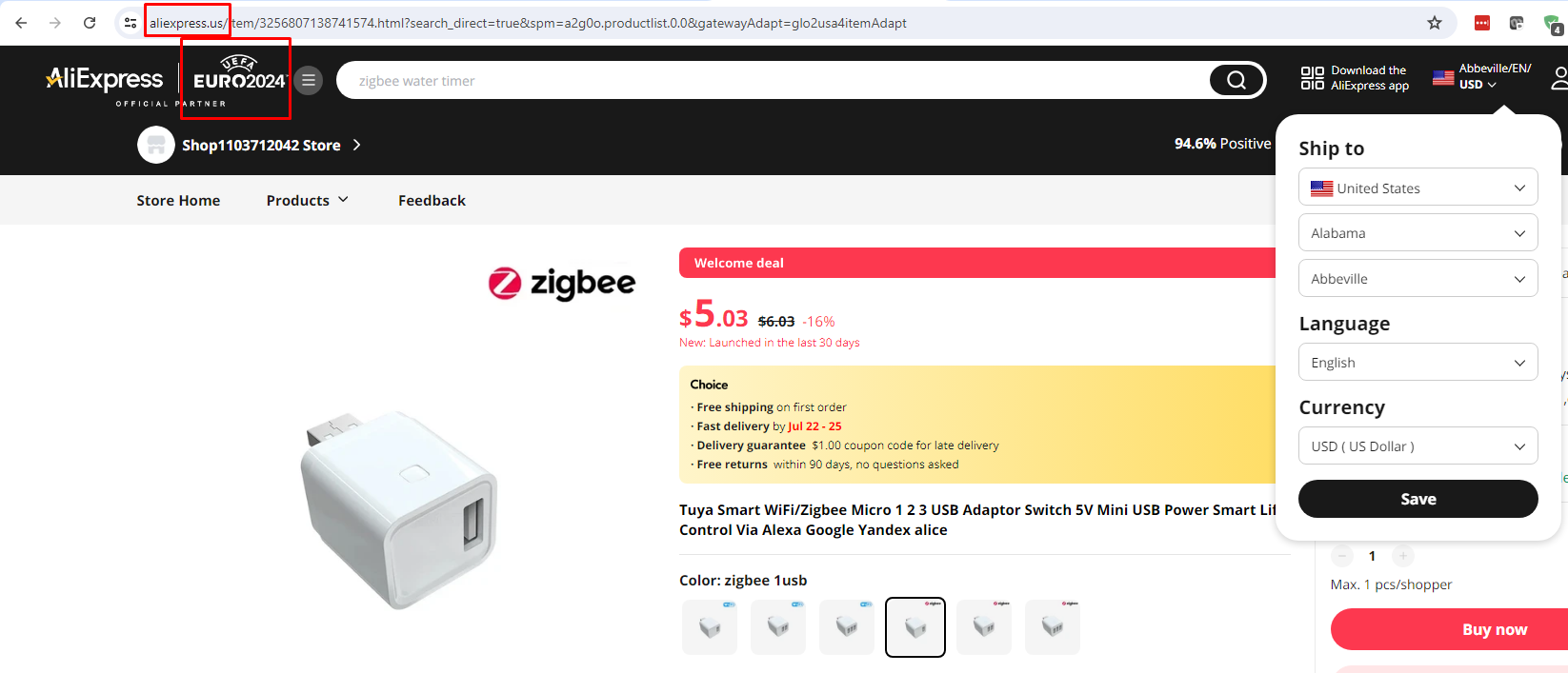

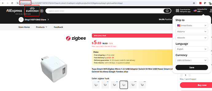

I see it when I change the shipping address to the United States.
If I change the address to Canada, the item will disappear...
BTW, it is funny to see the Euro2024 football championship advertised on the Aliexpress.us site! :slight_smile:
Ha, yes, I'm sure they're like "Americans love football!" Well, yes, but... :rofl:
:rofl: It's a mystery wrapped in an enigma, made into a shopping platform.
I also like how sometimes the price goes up when I log into my account, compared to the price shown in a private window. :thinking: :roll_eyes:
