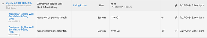

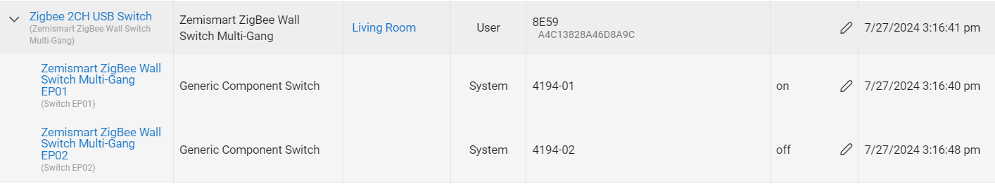

Received the Tuya clone today, both channels are controllable - this should reduce need for extra plug sockets!
Summary
Logs
dev:41942024-07-27 03:16:48.531 PMinfoZigbee 2CH USB Switch Child switch 02 turned off
dev:41942024-07-27 03:16:41.018 PMinfoZigbee 2CH USB Switch Child switch 02 turned on
dev:41942024-07-27 03:16:40.997 PMinfoZigbee 2CH USB Switch Parent switch is on
dev:41942024-07-27 03:16:40.995 PMinfoZigbee 2CH USB Switch Child switch 01 turned on
dev:41942024-07-27 03:16:40.913 PMinfoZigbee 2CH USB Switch Turning all child switches on
dev:41942024-07-27 03:16:38.676 PMinfoZigbee 2CH USB Switch Parent switch is off
dev:41942024-07-27 03:16:38.674 PMinfoZigbee 2CH USB Switch Child switch 02 turned off
dev:41942024-07-27 03:16:38.535 PMinfoZigbee 2CH USB Switch Turning all child switches off
dev:41942024-07-27 03:16:32.283 PMinfoZigbee 2CH USB Switch Child switch 01 is off
dev:41942024-07-27 03:16:28.331 PMinfoZigbee 2CH USB Switch Bind Response (deviceNetworkId 8E59, zigbeeId A4C13828A46D8A9C)
dev:41942024-07-27 03:16:18.520 PMinfoZigbee 2CH USB Switch Round-trip time is 68 ms (min=62 max=62 average=62)
dev:41942024-07-27 03:16:16.283 PMinfoZigbee 2CH USB Switch Child switch 02 is on
dev:41942024-07-27 03:16:16.270 PMinfoZigbee 2CH USB Switch Child switch 01 is off
dev:41942024-07-27 03:15:35.978 PMdebugZigbee 2CH USB Switch switch 02 is already in the requested state on
dev:41942024-07-27 03:15:35.976 PMdebugZigbee 2CH USB Switch Parsed descMap: [raw:8E590200060800001001, dni:8E59, endpoint:02, cluster:0006, size:08, attrId:0000, encoding:10, command:0A, value:01, clusterInt:6, attrInt:0] (description:read attr - raw: 8E590200060800001001, dni: 8E59, endpoint: 02, cluster: 0006, size: 08, attrId: 0000, encoding: 10, command: 0A, value: 01)
dev:41942024-07-27 03:15:32.987 PMinfoZigbee 2CH USB Switch Parent switch is on
dev:41942024-07-27 03:15:32.985 PMinfoZigbee 2CH USB Switch Child switch 02 turned on
dev:41942024-07-27 03:15:32.978 PMdebugZigbee 2CH USB Switch Parsed descMap: [raw:8E590200060800001001, dni:8E59, endpoint:02, cluster:0006, size:08, attrId:0000, encoding:10, command:0A, value:01, clusterInt:6, attrInt:0] (description:read attr - raw: 8E590200060800001001, dni: 8E59, endpoint: 02, cluster: 0006, size: 08, attrId: 0000, encoding: 10, command: 0A, value: 01)
dev:41942024-07-27 03:15:32.971 PMdebugZigbee 2CH USB Switch Zigbee 2CH USB Switch unprocessed EP: 02 cluster: 0006 command: 0B attrId: null
dev:41942024-07-27 03:15:32.969 PMdebugZigbee 2CH USB Switch Parsed descMap: [raw:catchall: 0104 0006 02 01 0040 00 8E59 00 00 0000 0B 01 0100, profileId:0104, clusterId:0006, clusterInt:6, sourceEndpoint:02, destinationEndpoint:01, options:0040, messageType:00, dni:8E59, isClusterSpecific:false, isManufacturerSpecific:false, manufacturerId:0000, command:0B, direction:01, data:[01, 00]] (description:catchall: 0104 0006 02 01 0040 00 8E59 00 00 0000 0B 01 0100)
dev:41942024-07-27 03:15:32.884 PMdebugZigbee 2CH USB Switch sending componentOn 4194-02
dev:41942024-07-27 03:15:24.993 PMdebugZigbee 2CH USB Switch Attribite FFE4 : 00
dev:41942024-07-27 03:15:24.992 PMdebugZigbee 2CH USB Switch Attribite FFE2 : 38
dev:41942024-07-27 03:15:24.992 PMdebugZigbee 2CH USB Switch Applicaiton version: 48
dev:41942024-07-27 03:15:24.989 PMdebugZigbee 2CH USB Switch Parsed descMap: [raw:8E590100001801002048E2FF2038E4FF2000, dni:8E59, endpoint:01, cluster:0000, size:18, attrId:0001, encoding:20, command:0A, value:48, clusterInt:0, attrInt:1, additionalAttrs:[[value:38, encoding:20, attrId:FFE2, consumedBytes:4, attrInt:65506], [value:00, encoding:20, attrId:FFE4, consumedBytes:4, attrInt:65508]]] (description:read attr - raw: 8E590100001801002048E2FF2038E4FF2000, dni: 8E59, endpoint: 01, cluster: 0000, size: 18, attrId: 0001, encoding: 20, command: 0A, value: 48E2FF2038E4FF2000)
dev:41942024-07-27 03:15:09.109 PMdebugZigbee 2CH USB Switch switch 02 is already in the requested state off
dev:41942024-07-27 03:15:09.106 PMdebugZigbee 2CH USB Switch Parsed descMap: [raw:8E590200060800001000, dni:8E59, endpoint:02, cluster:0006, size:08, attrId:0000, encoding:10, command:0A, value:00, clusterInt:6, attrInt:0] (description:read attr - raw: 8E590200060800001000, dni: 8E59, endpoint: 02, cluster: 0006, size: 08, attrId: 0000, encoding: 10, command: 0A, value: 00)
dev:41942024-07-27 03:15:06.694 PMinfoZigbee 2CH USB Switch Parent switch is off
dev:41942024-07-27 03:15:06.691 PMinfoZigbee 2CH USB Switch Child switch 02 turned off
dev:41942024-07-27 03:15:06.684 PMdebugZigbee 2CH USB Switch Parsed descMap: [raw:8E590200060800001000, dni:8E59, endpoint:02, cluster:0006, size:08, attrId:0000, encoding:10, command:0A, value:00, clusterInt:6, attrInt:0] (description:read attr - raw: 8E590200060800001000, dni: 8E59, endpoint: 02, cluster: 0006, size: 08, attrId: 0000, encoding: 10, command: 0A, value: 00)
dev:41942024-07-27 03:15:06.675 PMdebugZigbee 2CH USB Switch Zigbee 2CH USB Switch unprocessed EP: 02 cluster: 0006 command: 0B attrId: null
dev:41942024-07-27 03:15:06.668 PMdebugZigbee 2CH USB Switch Parsed descMap: [raw:catchall: 0104 0006 02 01 0040 00 8E59 00 00 0000 0B 01 0000, profileId:0104, clusterId:0006, clusterInt:6, sourceEndpoint:02, destinationEndpoint:01, options:0040, messageType:00, dni:8E59, isClusterSpecific:false, isManufacturerSpecific:false, manufacturerId:0000, command:0B, direction:01, data:[00, 00]] (description:catchall: 0104 0006 02 01 0040 00 8E59 00 00 0000 0B 01 0000)
dev:41942024-07-27 03:15:06.565 PMdebugZigbee 2CH USB Switch sending componentOff 4194-02
dev:41942024-07-27 03:15:05.175 PMinfoZigbee 2CH USB Switch Parent switch is on
dev:41942024-07-27 03:15:05.172 PMinfoZigbee 2CH USB Switch Child switch 02 turned on
dev:41942024-07-27 03:15:05.165 PMdebugZigbee 2CH USB Switch Parsed descMap: [raw:8E590200060800001001, dni:8E59, endpoint:02, cluster:0006, size:08, attrId:0000, encoding:10, command:0A, value:01, clusterInt:6, attrInt:0] (description:read attr - raw: 8E590200060800001001, dni: 8E59, endpoint: 02, cluster: 0006, size: 08, attrId: 0000, encoding: 10, command: 0A, value: 01)
dev:41942024-07-27 03:15:05.155 PMdebugZigbee 2CH USB Switch Zigbee 2CH USB Switch unprocessed EP: 02 cluster: 0006 command: 0B attrId: null
dev:41942024-07-27 03:15:05.153 PMdebugZigbee 2CH USB Switch Parsed descMap: [raw:catchall: 0104 0006 02 01 0040 00 8E59 00 00 0000 0B 01 0100, profileId:0104, clusterId:0006, clusterInt:6, sourceEndpoint:02, destinationEndpoint:01, options:0040, messageType:00, dni:8E59, isClusterSpecific:false, isManufacturerSpecific:false, manufacturerId:0000, command:0B, direction:01, data:[01, 00]] (description:catchall: 0104 0006 02 01 0040 00 8E59 00 00 0000 0B 01 0100)
dev:41942024-07-27 03:15:05.049 PMdebugZigbee 2CH USB Switch sending componentOn 4194-02
dev:41942024-07-27 03:14:59.935 PMdebugZigbee 2CH USB Switch switch 01 is already in the requested state off
dev:41942024-07-27 03:14:59.933 PMdebugZigbee 2CH USB Switch Parsed descMap: [raw:8E590100060800001000, dni:8E59, endpoint:01, cluster:0006, size:08, attrId:0000, encoding:10, command:0A, value:00, clusterInt:6, attrInt:0] (description:read attr - raw: 8E590100060800001000, dni: 8E59, endpoint: 01, cluster: 0006, size: 08, attrId: 0000, encoding: 10, command: 0A, value: 00)
dev:41942024-07-27 03:14:59.927 PMdebugZigbee 2CH USB Switch switch 01 is already in the requested state off
dev:41942024-07-27 03:14:59.925 PMdebugZigbee 2CH USB Switch Parsed descMap: [raw:8E590100060800001000, dni:8E59, endpoint:01, cluster:0006, size:08, attrId:0000, encoding:10, command:0A, value:00, clusterInt:6, attrInt:0] (description:read attr - raw: 8E590100060800001000, dni: 8E59, endpoint: 01, cluster: 0006, size: 08, attrId: 0000, encoding: 10, command: 0A, value: 00)
dev:41942024-07-27 03:14:56.940 PMinfoZigbee 2CH USB Switch Parent switch is off
dev:41942024-07-27 03:14:56.938 PMinfoZigbee 2CH USB Switch Child switch 01 turned off
dev:41942024-07-27 03:14:56.926 PMdebugZigbee 2CH USB Switch Parsed descMap: [raw:8E590100060800001000, dni:8E59, endpoint:01, cluster:0006, size:08, attrId:0000, encoding:10, command:0A, value:00, clusterInt:6, attrInt:0] (description:read attr - raw: 8E590100060800001000, dni: 8E59, endpoint: 01, cluster: 0006, size: 08, attrId: 0000, encoding: 10, command: 0A, value: 00)
dev:41942024-07-27 03:14:56.920 PMdebugZigbee 2CH USB Switch Zigbee 2CH USB Switch unprocessed EP: 01 cluster: 0006 command: 0B attrId: null
dev:41942024-07-27 03:14:56.918 PMdebugZigbee 2CH USB Switch Parsed descMap: [raw:catchall: 0104 0006 01 01 0040 00 8E59 00 00 0000 0B 01 0000, profileId:0104, clusterId:0006, clusterInt:6, sourceEndpoint:01, destinationEndpoint:01, options:0040, messageType:00, dni:8E59, isClusterSpecific:false, isManufacturerSpecific:false, manufacturerId:0000, command:0B, direction:01, data:[00, 00]] (description:catchall: 0104 0006 01 01 0040 00 8E59 00 00 0000 0B 01 0000)
dev:41942024-07-27 03:14:56.868 PMdebugZigbee 2CH USB Switch sending componentOff 4194-01
dev:41942024-07-27 03:14:55.179 PMdebugZigbee 2CH USB Switch switch 01 is already in the requested state on
dev:41942024-07-27 03:14:55.177 PMdebugZigbee 2CH USB Switch Parsed descMap: [raw:8E590100060800001001, dni:8E59, endpoint:01, cluster:0006, size:08, attrId:0000, encoding:10, command:0A, value:01, clusterInt:6, attrInt:0] (description:read attr - raw: 8E590100060800001001, dni: 8E59, endpoint: 01, cluster: 0006, size: 08, attrId: 0000, encoding: 10, command: 0A, value: 01)
dev:41942024-07-27 03:14:55.170 PMdebugZigbee 2CH USB Switch switch 01 is already in the requested state on
dev:41942024-07-27 03:14:55.168 PMdebugZigbee 2CH USB Switch Parsed descMap: [raw:8E590100060800001001, dni:8E59, endpoint:01, cluster:0006, size:08, attrId:0000, encoding:10, command:0A, value:01, clusterInt:6, attrInt:0] (description:read attr - raw: 8E590100060800001001, dni: 8E59, endpoint: 01, cluster: 0006, size: 08, attrId: 0000, encoding: 10, command: 0A, value: 01)
dev:41942024-07-27 03:14:52.180 PMinfoZigbee 2CH USB Switch Parent switch is on
dev:41942024-07-27 03:14:52.178 PMinfoZigbee 2CH USB Switch Child switch 01 turned on
dev:41942024-07-27 03:14:52.172 PMdebugZigbee 2CH USB Switch Parsed descMap: [raw:8E590100060800001001, dni:8E59, endpoint:01, cluster:0006, size:08, attrId:0000, encoding:10, command:0A, value:01, clusterInt:6, attrInt:0] (description:read attr - raw: 8E590100060800001001, dni: 8E59, endpoint: 01, cluster: 0006, size: 08, attrId: 0000, encoding: 10, command: 0A, value: 01)
dev:41942024-07-27 03:14:52.162 PMdebugZigbee 2CH USB Switch Zigbee 2CH USB Switch unprocessed EP: 01 cluster: 0006 command: 0B attrId: null
dev:41942024-07-27 03:14:52.160 PMdebugZigbee 2CH USB Switch Parsed descMap: [raw:catchall: 0104 0006 01 01 0040 00 8E59 00 00 0000 0B 01 0100, profileId:0104, clusterId:0006, clusterInt:6, sourceEndpoint:01, destinationEndpoint:01, options:0040, messageType:00, dni:8E59, isClusterSpecific:false, isManufacturerSpecific:false, manufacturerId:0000, command:0B, direction:01, data:[01, 00]] (description:catchall: 0104 0006 01 01 0040 00 8E59 00 00 0000 0B 01 0100)
dev:41942024-07-27 03:14:52.113 PMdebugZigbee 2CH USB Switch sending componentOn 4194-01

dev:41942024-07-27 03:12:25.723 PMdebugZemismart ZigBee Wall Switch Multi-Gang switch 01 is already in the requested state off
dev:41942024-07-27 03:12:25.716 PMdebugZemismart ZigBee Wall Switch Multi-Gang Parsed descMap: [raw:8E5901000624000010000140210000024021000002803002, dni:8E59, endpoint:01, cluster:0006, size:24, attrId:0000, encoding:10, command:0A, value:00, clusterInt:6, attrInt:0, additionalAttrs:[[value:0000, encoding:21, attrId:4001, consumedBytes:5, attrInt:16385], [value:0000, encoding:21, attrId:4002, consumedBytes:5, attrInt:16386], [value:02, encoding:30, attrId:8002, consumedBytes:4, attrInt:32770]]] (description:read attr - raw: 8E5901000624000010000140210000024021000002803002, dni: 8E59, endpoint: 01, cluster: 0006, size: 24, attrId: 0000, encoding: 10, command: 0A, value: 000140210000024021000002803002)
dev:41942024-07-27 03:12:25.674 PMinfoZemismart ZigBee Wall Switch Multi-Gang attribute E000_D002 is: 02000A (?)
dev:41942024-07-27 03:12:25.673 PMdebugZemismart ZigBee Wall Switch Multi-Gang processOnOfClusterOtherAttr: EXCEPTION java.lang.NumberFormatException: For input string: "02000A" while processing attrId: D002 value: 02000A as Integer. Using valueStr instead.
dev:41942024-07-27 03:12:25.668 PMdebugZemismart ZigBee Wall Switch Multi-Gang processOnOfClusterOtherAttr attribute [cluster:E000, attrId:D002, value:02000A, status:null]
dev:41942024-07-27 03:12:25.666 PMdebugZemismart ZigBee Wall Switch Multi-Gang Parsed descMap: [raw:8E5901E0000C02D04802000A, dni:8E59, endpoint:01, cluster:E000, size:0C, attrId:D002, encoding:48, command:0A, value:02000A, clusterInt:57344, attrInt:53250] (description:read attr - raw: 8E5901E0000C02D04802000A, dni: 8E59, endpoint: 01, cluster: E000, size: 0C, attrId: D002, encoding: 48, command: 0A, value: 02000A)
dev:41942024-07-27 03:12:25.617 PMinfoZemismart ZigBee Wall Switch Multi-Gang attribute E000_D001 is: 20006 (20006)
dev:41942024-07-27 03:12:25.616 PMdebugZemismart ZigBee Wall Switch Multi-Gang processOnOfClusterOtherAttr attribute [cluster:E000, attrId:D001, value:020006, status:null]
dev:41942024-07-27 03:12:25.615 PMdebugZemismart ZigBee Wall Switch Multi-Gang Parsed descMap: [raw:8E5901E0000C01D048020006, dni:8E59, endpoint:01, cluster:E000, size:0C, attrId:D001, encoding:48, command:0A, value:020006, clusterInt:57344, attrInt:53249] (description:read attr - raw: 8E5901E0000C01D048020006, dni: 8E59, endpoint: 01, cluster: E000, size: 0C, attrId: D001, encoding: 48, command: 0A, value: 020006)
dev:41942024-07-27 03:12:25.570 PMinfoZemismart ZigBee Wall Switch Multi-Gang attribute E000_D003 is: AAAAAgAA (?)
dev:41942024-07-27 03:12:25.569 PMdebugZemismart ZigBee Wall Switch Multi-Gang processOnOfClusterOtherAttr: EXCEPTION java.lang.NumberFormatException: For input string: "AAAAAgAA" while processing attrId: D003 value: AAAAAgAA as Integer. Using valueStr instead.
dev:41942024-07-27 03:12:25.567 PMdebugZemismart ZigBee Wall Switch Multi-Gang processOnOfClusterOtherAttr attribute [cluster:E000, attrId:D003, value:AAAAAgAA, status:null]
dev:41942024-07-27 03:12:25.563 PMdebugZemismart ZigBee Wall Switch Multi-Gang Parsed descMap: [raw:8E5901E0001803D042084141414141674141, dni:8E59, endpoint:01, cluster:E000, size:18, attrId:D003, encoding:42, command:0A, value:AAAAAgAA, clusterInt:57344, attrInt:53251] (description:read attr - raw: 8E5901E0001803D042084141414141674141, dni: 8E59, endpoint: 01, cluster: E000, size: 18, attrId: D003, encoding: 42, command: 0A, value: 084141414141674141)
dev:41942024-07-27 03:12:24.445 PMdebugZemismart ZigBee Wall Switch Multi-Gang Parent switch is already off
dev:41942024-07-27 03:12:24.443 PMinfoZemismart ZigBee Wall Switch Multi-Gang Child switch 01 is off
dev:41942024-07-27 03:12:24.437 PMdebugZemismart ZigBee Wall Switch Multi-Gang Parsed descMap: [raw:8E590100060A00001000, dni:8E59, endpoint:01, cluster:0006, size:0A, attrId:0000, encoding:10, command:01, value:00, clusterInt:6, attrInt:0] (description:read attr - raw: 8E590100060A00001000, dni: 8E59, endpoint: 01, cluster: 0006, size: 0A, attrId: 0000, encoding: 10, command: 01, value: 00)
dev:41942024-07-27 03:12:24.357 PMdebugZemismart ZigBee Wall Switch Multi-Gang Parent switch is already off
dev:41942024-07-27 03:12:24.356 PMinfoZemismart ZigBee Wall Switch Multi-Gang Child switch 01 is off
dev:41942024-07-27 03:12:24.349 PMdebugZemismart ZigBee Wall Switch Multi-Gang Parsed descMap: [raw:8E590100060A00001000, dni:8E59, endpoint:01, cluster:0006, size:0A, attrId:0000, encoding:10, command:01, value:00, clusterInt:6, attrInt:0] (description:read attr - raw: 8E590100060A00001000, dni: 8E59, endpoint: 01, cluster: 0006, size: 0A, attrId: 0000, encoding: 10, command: 01, value: 00)
dev:41942024-07-27 03:12:22.447 PMinfoZemismart ZigBee Wall Switch Multi-Gang zigbee configure reporting response: Success [00, 00, 00, 00]
dev:41942024-07-27 03:12:22.445 PMdebugZemismart ZigBee Wall Switch Multi-Gang Parsed descMap: [raw:catchall: 0104 0006 01 01 0040 00 8E59 00 00 0000 07 01 00000000, profileId:0104, clusterId:0006, clusterInt:6, sourceEndpoint:01, destinationEndpoint:01, options:0040, messageType:00, dni:8E59, isClusterSpecific:false, isManufacturerSpecific:false, manufacturerId:0000, command:07, direction:01, data:[00, 00, 00, 00]] (description:catchall: 0104 0006 01 01 0040 00 8E59 00 00 0000 07 01 00000000)
dev:41942024-07-27 03:12:22.374 PMinfoZemismart ZigBee Wall Switch Multi-Gang zigbee configure reporting response: Success [00, 00, 00, 00]
dev:41942024-07-27 03:12:22.353 PMdebugZemismart ZigBee Wall Switch Multi-Gang Parsed descMap: [raw:catchall: 0104 0006 01 01 0040 00 8E59 00 00 0000 07 01 00000000, profileId:0104, clusterId:0006, clusterInt:6, sourceEndpoint:01, destinationEndpoint:01, options:0040, messageType:00, dni:8E59, isClusterSpecific:false, isManufacturerSpecific:false, manufacturerId:0000, command:07, direction:01, data:[00, 00, 00, 00]] (description:catchall: 0104 0006 01 01 0040 00 8E59 00 00 0000 07 01 00000000)
dev:41942024-07-27 03:12:20.742 PMdebugZemismart ZigBee Wall Switch Multi-Gang Zemismart ZigBee Wall Switch Multi-Gang unprocessed EP: 01 cluster: 0000 command: 04 attrId: null
dev:41942024-07-27 03:12:20.740 PMdebugZemismart ZigBee Wall Switch Multi-Gang Parsed descMap: [raw:catchall: 0104 0000 01 01 0040 00 8E59 00 00 0000 04 01 00, profileId:0104, clusterId:0000, clusterInt:0, sourceEndpoint:01, destinationEndpoint:01, options:0040, messageType:00, dni:8E59, isClusterSpecific:false, isManufacturerSpecific:false, manufacturerId:0000, command:04, direction:01, data:[00]] (description:catchall: 0104 0000 01 01 0040 00 8E59 00 00 0000 04 01 00)
dev:41942024-07-27 03:12:20.733 PMinfoZemismart ZigBee Wall Switch Multi-Gang Bind Response (deviceNetworkId 8E59, zigbeeId A4C13828A46D8A9C)
dev:41942024-07-27 03:12:20.727 PMdebugZemismart ZigBee Wall Switch Multi-Gang Parsed descMap: [raw:catchall: 0000 8021 00 00 0040 00 8E59 00 00 0000 00 00 4D00, profileId:0000, clusterId:8021, clusterInt:32801, sourceEndpoint:00, destinationEndpoint:00, options:0040, messageType:00, dni:8E59, isClusterSpecific:false, isManufacturerSpecific:false, manufacturerId:0000, command:00, direction:00, data:[4D, 00]] (description:catchall: 0000 8021 00 00 0040 00 8E59 00 00 0000 00 00 4D00)
dev:41942024-07-27 03:12:20.677 PMdebugZemismart ZigBee Wall Switch Multi-Gang Zemismart ZigBee Wall Switch Multi-Gang unprocessed EP: 01 cluster: 0000 command: 04 attrId: null
dev:41942024-07-27 03:12:20.675 PMdebugZemismart ZigBee Wall Switch Multi-Gang Parsed descMap: [raw:catchall: 0104 0000 01 01 0040 00 8E59 00 00 0000 04 01 00, profileId:0104, clusterId:0000, clusterInt:0, sourceEndpoint:01, destinationEndpoint:01, options:0040, messageType:00, dni:8E59, isClusterSpecific:false, isManufacturerSpecific:false, manufacturerId:0000, command:04, direction:01, data:[00]] (description:catchall: 0104 0000 01 01 0040 00 8E59 00 00 0000 04 01 00)
dev:41942024-07-27 03:12:20.668 PMinfoZemismart ZigBee Wall Switch Multi-Gang Bind Response (deviceNetworkId 8E59, zigbeeId A4C13828A46D8A9C)
dev:41942024-07-27 03:12:20.662 PMdebugZemismart ZigBee Wall Switch Multi-Gang Parsed descMap: [raw:catchall: 0000 8021 00 00 0040 00 8E59 00 00 0000 00 00 4F00, profileId:0000, clusterId:8021, clusterInt:32801, sourceEndpoint:00, destinationEndpoint:00, options:0040, messageType:00, dni:8E59, isClusterSpecific:false, isManufacturerSpecific:false, manufacturerId:0000, command:00, direction:00, data:[4F, 00]] (description:catchall: 0000 8021 00 00 0040 00 8E59 00 00 0000 00 00 4F00)
dev:41942024-07-27 03:12:20.558 PMdebugZemismart ZigBee Wall Switch Multi-Gang Model Identifier: TS0002
dev:41942024-07-27 03:12:20.557 PMdebugZemismart ZigBee Wall Switch Multi-Gang Applicaiton version: 48
dev:41942024-07-27 03:12:20.556 PMdebugZemismart ZigBee Wall Switch Multi-Gang ZLC version: 03
dev:41942024-07-27 03:12:20.554 PMdebugZemismart ZigBee Wall Switch Multi-Gang Manufacturer name: _TZ3000_h1ipgkwn
dev:41942024-07-27 03:12:20.550 PMdebugZemismart ZigBee Wall Switch Multi-Gang Parsed descMap: [raw:8E5901000068040042105F545A333030305F68316970676B776E0000002003010000204805000042065453303030320700003001FEFF003000, dni:8E59, endpoint:01, cluster:0000, size:68, attrId:0004, encoding:42, command:01, value:_TZ3000_h1ipgkwn, clusterInt:0, attrInt:4, additionalAttrs:[[value:03, encoding:20, attrId:0000, consumedBytes:4, attrInt:0], [value:48, encoding:20, attrId:0001, consumedBytes:4, attrInt:1], [value:TS0002, encoding:42, attrId:0005, consumedBytes:9, attrInt:5]]] (description:read attr - raw: 8E5901000068040042105F545A333030305F68316970676B776E0000002003010000204805000042065453303030320700003001FEFF003000, dni: 8E59, endpoint: 01, cluster: 0000, size: 68, attrId: 0004, encoding: 42, command: 01, value: 105F545A333030305F68316970676B776E0000002003010000204805000042065453303030320700003001FEFF003000)
dev:41942024-07-27 03:12:20.287 PMdebugZemismart ZigBee Wall Switch Multi-Gang Parent switch is already off
dev:41942024-07-27 03:12:20.285 PMinfoZemismart ZigBee Wall Switch Multi-Gang Child switch 02 is off
dev:41942024-07-27 03:12:20.278 PMdebugZemismart ZigBee Wall Switch Multi-Gang Parsed descMap: [raw:8E590200060A00001000, dni:8E59, endpoint:02, cluster:0006, size:0A, attrId:0000, encoding:10, command:01, value:00, clusterInt:6, attrInt:0] (description:read attr - raw: 8E590200060A00001000, dni: 8E59, endpoint: 02, cluster: 0006, size: 0A, attrId: 0000, encoding: 10, command: 01, value: 00)
dev:41942024-07-27 03:12:20.271 PMinfoZemismart ZigBee Wall Switch Multi-Gang Parent switch is off
dev:41942024-07-27 03:12:20.257 PMinfoZemismart ZigBee Wall Switch Multi-Gang Child switch 01 is off
dev:41942024-07-27 03:12:20.201 PMdebugZemismart ZigBee Wall Switch Multi-Gang Parsed descMap: [raw:8E590100060A00001000, dni:8E59, endpoint:01, cluster:0006, size:0A, attrId:0000, encoding:10, command:01, value:00, clusterInt:6, attrInt:0] (description:read attr - raw: 8E590100060A00001000, dni: 8E59, endpoint: 01, cluster: 0006, size: 0A, attrId: 0000, encoding: 10, command: 01, value: 00)
dev:41942024-07-27 03:12:20.194 PMdebugZemismart ZigBee Wall Switch Multi-Gang Model Identifier: TS0002
dev:41942024-07-27 03:12:20.194 PMdebugZemismart ZigBee Wall Switch Multi-Gang Applicaiton version: 48
dev:41942024-07-27 03:12:20.192 PMdebugZemismart ZigBee Wall Switch Multi-Gang ZLC version: 03
dev:41942024-07-27 03:12:20.191 PMdebugZemismart ZigBee Wall Switch Multi-Gang Manufacturer name: _TZ3000_h1ipgkwn
dev:41942024-07-27 03:12:20.174 PMdebugZemismart ZigBee Wall Switch Multi-Gang Parsed descMap: [raw:8E5901000068040042105F545A333030305F68316970676B776E0000002003010000204805000042065453303030320700003001FEFF003000, dni:8E59, endpoint:01, cluster:0000, size:68, attrId:0004, encoding:42, command:01, value:_TZ3000_h1ipgkwn, clusterInt:0, attrInt:4, additionalAttrs:[[value:03, encoding:20, attrId:0000, consumedBytes:4, attrInt:0], [value:48, encoding:20, attrId:0001, consumedBytes:4, attrInt:1], [value:TS0002, encoding:42, attrId:0005, consumedBytes:9, attrInt:5]]] (description:read attr - raw: 8E5901000068040042105F545A333030305F68316970676B776E0000002003010000204805000042065453303030320700003001FEFF003000, dni: 8E59, endpoint: 01, cluster: 0000, size: 68, attrId: 0004, encoding: 42, command: 01, value: 105F545A333030305F68316970676B776E0000002003010000204805000042065453303030320700003001FEFF003000)
dev:41942024-07-27 03:12:20.136 PMdebugZemismart ZigBee Wall Switch Multi-Gang sendZigbeeCommands : [he raw 0x8E59 1 0x01 0x0000 {10 00 00 04 00 00 00 01 00 05 00 07 00 FE FF}, delay 200, he wattr 0x8E59 0x01 0x0000 0xFFDE 0x20 {0D} {}, delay 50, zdo bind 0x8E59 0x01 0x01 6 {A4C13828A46D8A9C} {}, delay 2000, he cr 0x8E59 0x01 6 0 16 0 600 {}, delay 2000, he rattr 0x8E59 0x01 6 0 {}, delay 2000]
dev:41942024-07-27 03:12:20.133 PMdebugZemismart ZigBee Wall Switch Multi-Gang configure()..
dev:41942024-07-27 03:12:20.128 PMdebugZemismart ZigBee Wall Switch Multi-Gang sending componentRefresh 4194-02 Zemismart ZigBee Wall Switch Multi-Gang EP02
dev:41942024-07-27 03:12:20.107 PMinfoZemismart ZigBee Wall Switch Multi-Gang Creatung device 4194-02
dev:41942024-07-27 03:12:20.100 PMdebugZemismart ZigBee Wall Switch Multi-Gang sending componentRefresh 4194-01 Zemismart ZigBee Wall Switch Multi-Gang EP01
dev:41942024-07-27 03:12:20.066 PMinfoZemismart ZigBee Wall Switch Multi-Gang Creatung device 4194-01
dev:41942024-07-27 03:12:20.060 PMdebugZemismart ZigBee Wall Switch Multi-Gang Parent createChildDevices
dev:41942024-07-27 03:12:20.059 PMinfoZemismart ZigBee Wall Switch Multi-Gang model: TS0002 gangs:2 child devices: 2
dev:41942024-07-27 03:12:20.048 PMdebugZemismart ZigBee Wall Switch Multi-Gang Parent deleteChildren
dev:41942024-07-27 03:12:20.047 PMdebugZemismart ZigBee Wall Switch Multi-Gang Parent setupChildDevices
dev:41942024-07-27 03:12:20.044 PMdebugZemismart ZigBee Wall Switch Multi-Gang sendZigbeeCommands : [he raw 0x8E59 1 0x01 0x0000 {10 00 00 04 00 00 00 01 00 05 00 07 00 FE FF}, delay 200, he wattr 0x8E59 0x01 0x0000 0xFFDE 0x20 {0D} {}, delay 50, zdo bind 0x8E59 0x01 0x01 6 {A4C13828A46D8A9C} {}, delay 2000, he cr 0x8E59 0x01 6 0 16 0 600 {}, delay 2000, he rattr 0x8E59 0x01 6 0 {}, delay 2000]
dev:41942024-07-27 03:12:20.031 PMdebugZemismart ZigBee Wall Switch Multi-Gang configure()..
dev:41942024-07-27 03:12:20.027 PMinfoZemismart ZigBee Wall Switch Multi-Gang InitializeVars()... fullInit = true
dev:41942024-07-27 03:12:20.026 PMdebugZemismart ZigBee Wall Switch Multi-Gang Initializing...
dev:41942024-07-27 03:12:20.025 PMinfoZemismart ZigBee Wall Switch Multi-Gang model TS0002, manufacturer _TZ3000_h1ipgkwn, application 48, endpointId 01
dev:41942024-07-27 03:12:20.024 PMinfoZemismart ZigBee Wall Switch Multi-Gang Parent installed, typeName Zemismart ZigBee Wall Switch Multi-Gang, version 1.1.3 2024/07/24 9:28 PM, deviceNetworkId 8E59, zigbeeId A4C13828A46D8A9C
Thank you for the logs! I see some minor details that can be improved in the Zemismart driver next update.
This Tuya USB switch uses the standard ZCL clusters, so it should work also when the HE inbuilt Zigbee Generic Multiendoint Switch driver is assigned.

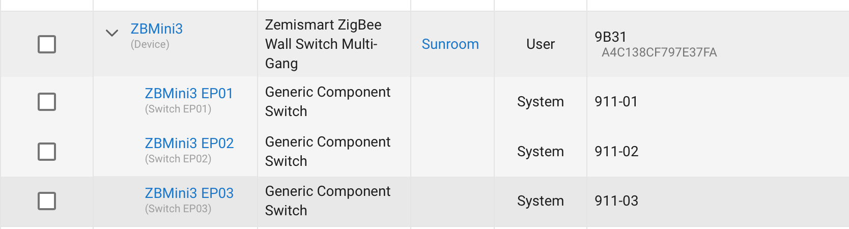

Just got my 3port Tuya clone.
ev:9112024-08-01 05:03:26.853 PMinfoscheduling health check every 240 minutes by Activity check method
dev:9112024-08-01 05:03:26.742 PMinfoZBMini3 driver version 3.2.1 2024/06/05 2:46 PM (TS0003 _TZ3000_mw1pqqqt) (C-8 2.3.9.166)
dev:9112024-08-01 05:03:26.736 PMinfoZBMini3 updated()...
dev:9112024-08-01 05:02:53.843 PMinfoZBMini3 ZBMini3 is on [Refresh]
dev:9112024-08-01 05:02:53.298 PMinfoZBMini3 ZBMini3 is on [physical]
dev:9112024-08-01 05:02:51.880 PMinfoZBMini3 is now online!
dev:9112024-08-01 05:02:51.879 PMinfoZBMini3 healthStatus changed to online
dev:9112024-08-01 05:02:51.689 PMinfoHealth Check is disabled!
dev:9112024-08-01 05:01:24.214 PMinfofingerprint profileId:"0104", endpointId:"01", inClusters:"0003,0004,0005,0006,0702,0B04,E000,E001,0000", outClusters:"0019,000A", model:"TS0003", manufacturer:"_TZ3000_mw1pqqqt", controllerType: "ZGB"
dev:9112024-08-01 05:01:24.114 PMtraceZCL version:03
dev:9112024-08-01 05:01:24.111 PMtraceSoftware Build Id:unknown
dev:9112024-08-01 05:01:24.109 PMtraceModel:TS0003
dev:9112024-08-01 05:01:24.107 PMtraceManufacturer:_TZ3000_mw1pqqqt
which driver for this 3 USB SWITCH.
Works out-of-the-box! Thanks
FYI: Although I named it ZBMimi it IS a ZBMicro.
