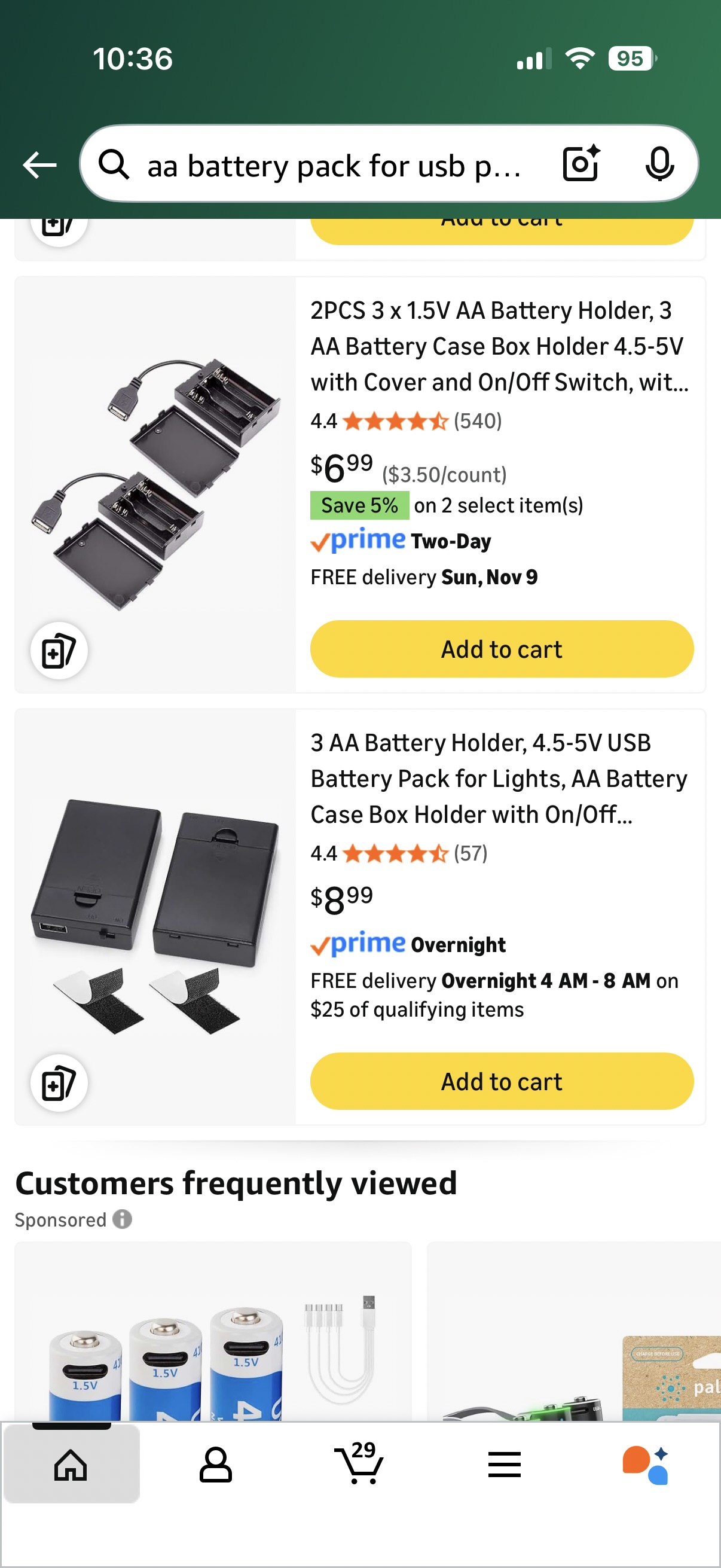

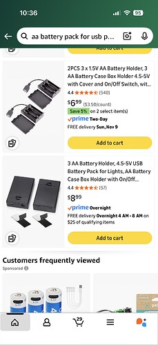

Is there any way to make these work on a powerbank? I had hoped to use one with a powerbank to control some of the kids LED light wall decorations without needing to run a cable to a socket. But I'm guessing the low power use means after about a minute the powerbank switches off the power.
Something like this should work
