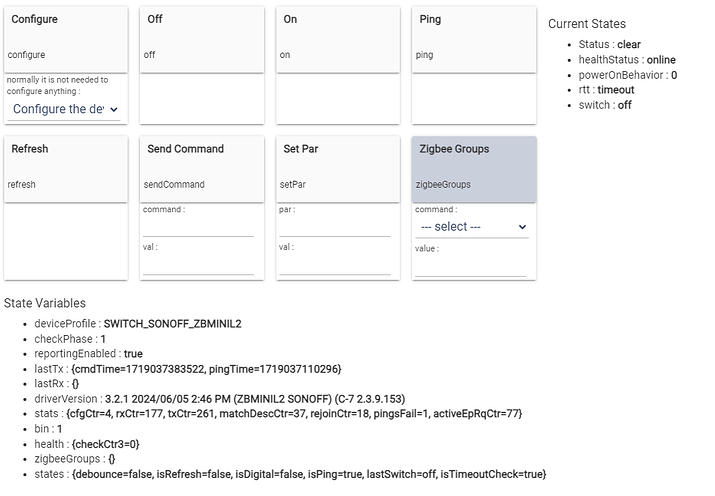

It is also strange that my ZBMINIL2 (also the ZBMICRO) is staying connected to the old C-7 hub; I moved them yesterday. I have also cleared the rejoinCtr statistics this morning, lets see how it goes for a longer period.

I checked the stats on my C-7 hub after moving the two devices yesterday - and today I see no problems with drop-offs / going offline :
There are a lot of 'Active Endpoint Request' ZDO messages, but this is the weird way that Sonoff checks for the online presence of the hub...
The 'rejoinCtr' counting the number of the ZDO rejoin commands (sent by the device when it has dropped the connection and is requesting to join the network again) are zero (not registered in the state variable) - this means no problems on my C-7 hub.

This is my CHildAndRouterInfo :
I am running the ZBMICRO on high power, probably that's why the ZBMINIL2 picked it as a router (repeater).
