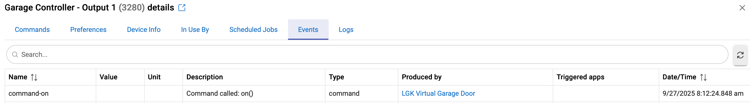

The community driver only shows this stange "Child on @ ep5" message:
But in the events for the digital output I can see it tried to open to trigger the relay, but nothing happened. There's noting in the logs for the child device.
I can switch back to the Hubitat driver if that helps, but it's a massive PITA due to the parent/child relationship. If I can find my spare Implant, I'll do some more testing with that.
