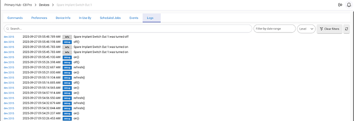

Ok the HE driver does trigger the relays in ZWJS (state wasnt updating, but now is, not sure why):

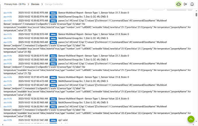

Child Logs:
Parent:

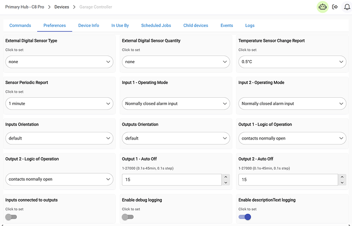

@bcopeland Lol, I thought I should prolly test the inputs for the HE driver too, and on ZWJS I can't get the inputs to work (relays are fine tho) - I've tested my config on both ZW stacks to rule it out, and everything works fine on the legacy stack. There's nothing in the Child logs, but the parent seems to recognise something happening for both inputs.
Here's my config:
Btw, one undesirable behaviour I'm seeing, and it may be the SI itself, is when you save a config change, it triggers the relays - both drivers do it, but it's not ideal.

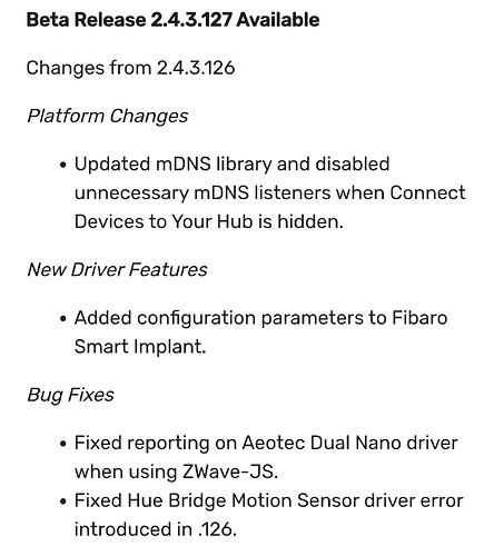

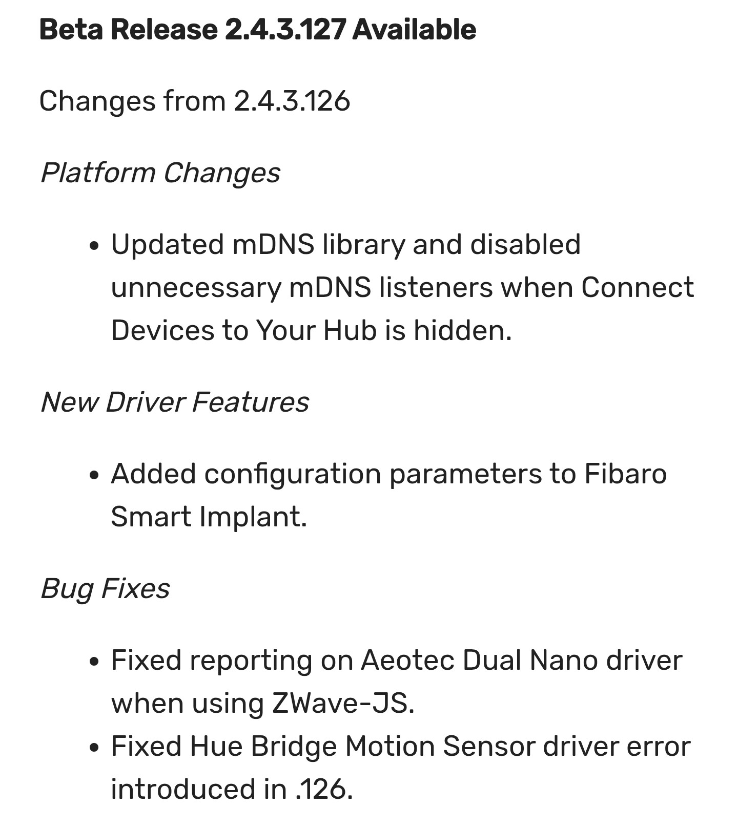

The reason @aaiyar was asking if you are enrolled in beta, is because the fixes have been released to the Beta channel. I don't expect the release to stay in beta a long time, so you don't have to enroll your hubs:

@bcopeland the Dual Nano Switch issue is 100% resolved in 2.4.3.127.

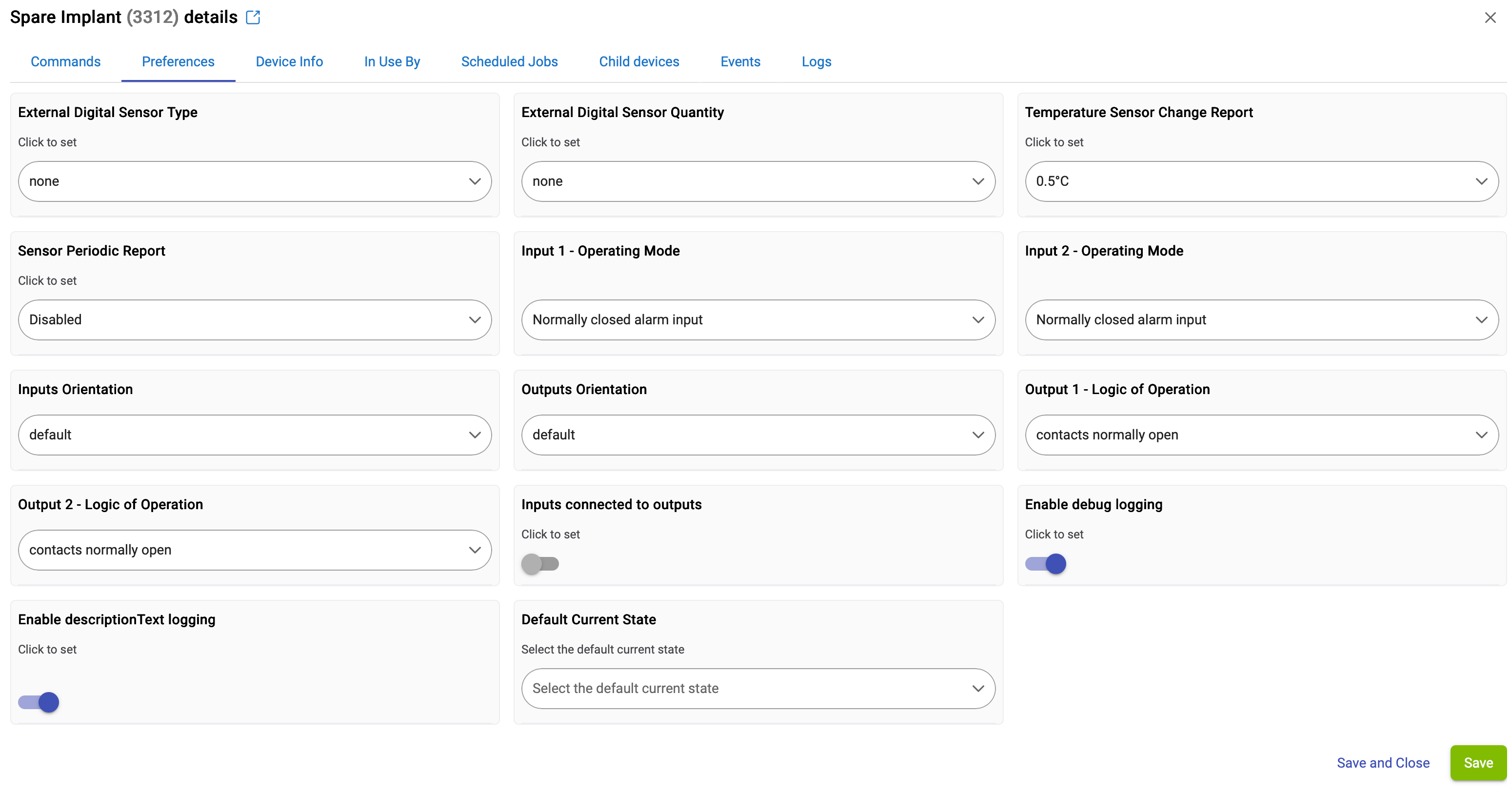

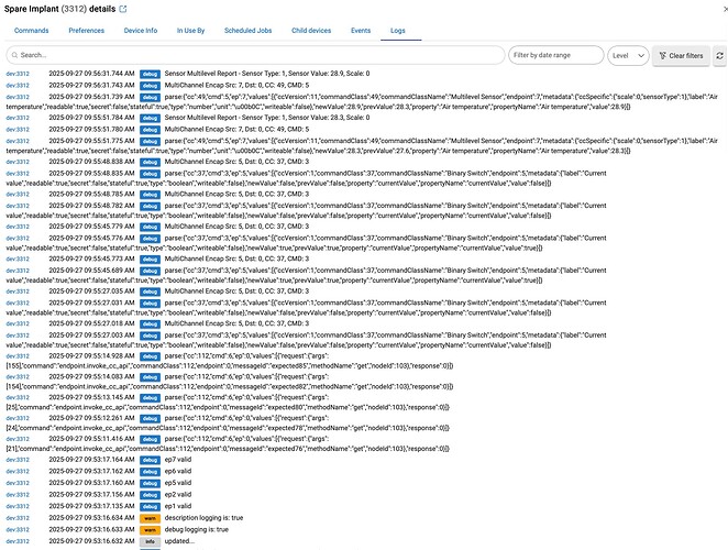

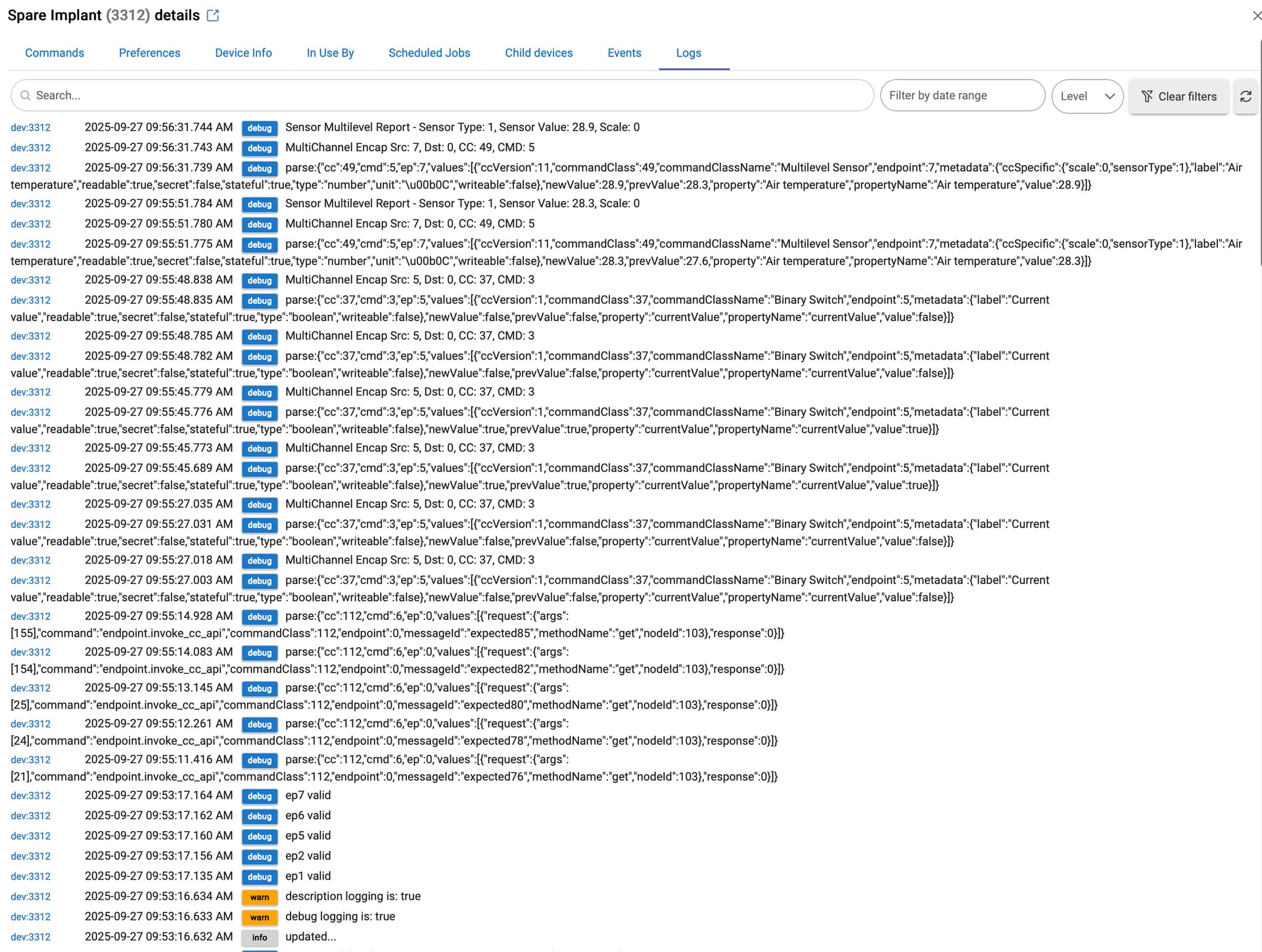

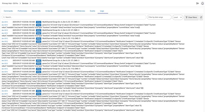

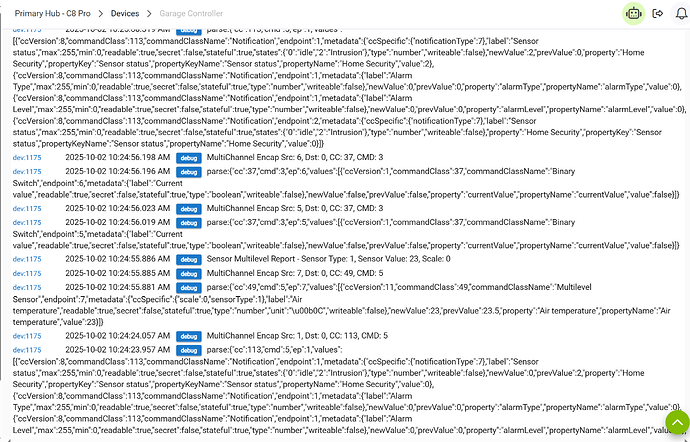

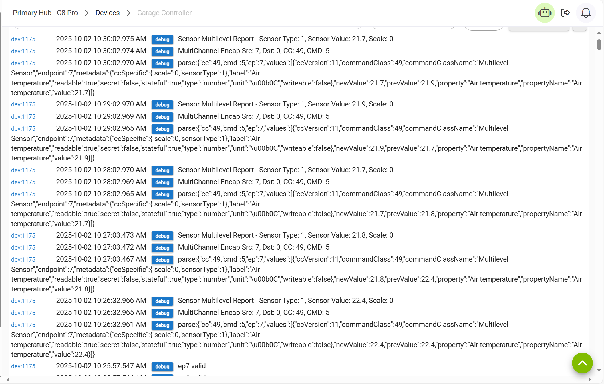

However Im still having issues with the Smart Implants in 2.4.3.127 + ZWJS. Basically, I'm not seeing the inputs update, and I cant trigger the relays. I'll do some more testing with my spare unit and confirm it isnt just an issue with my garage door unit.

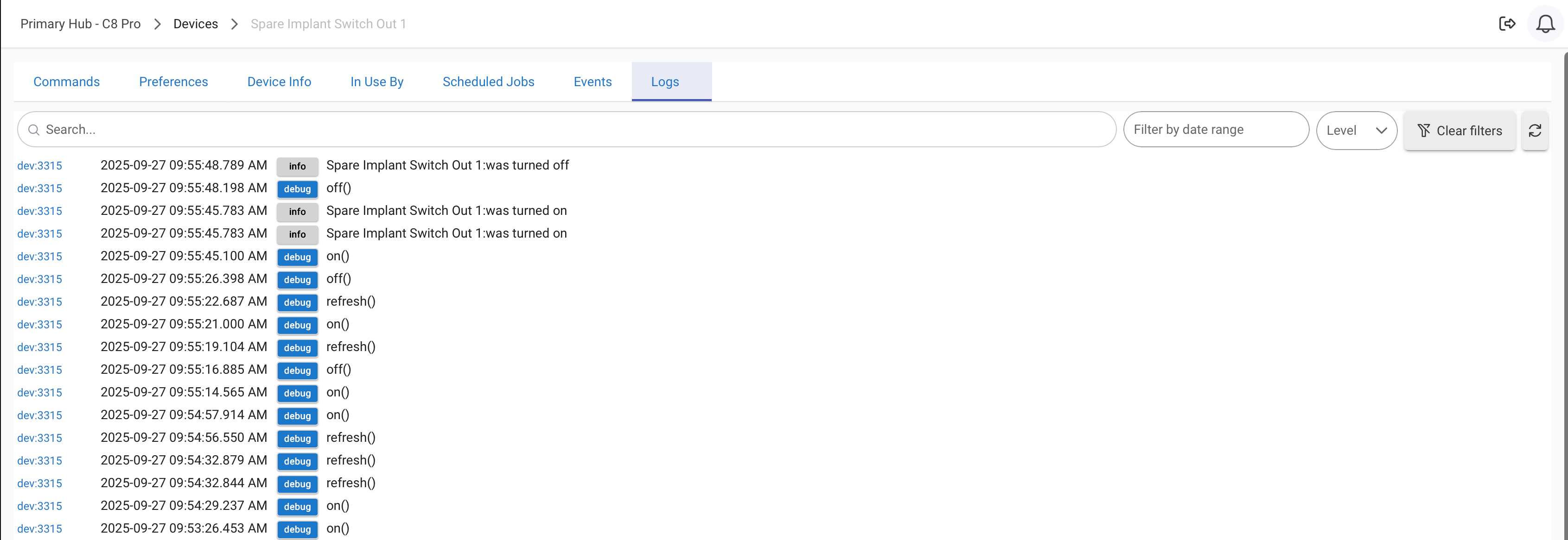

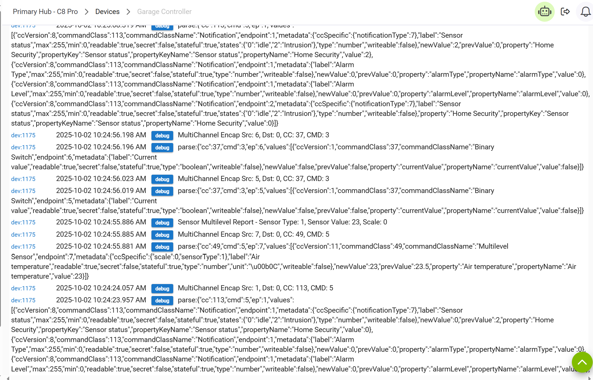

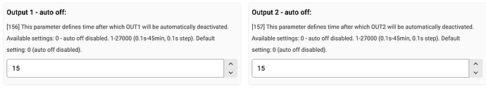

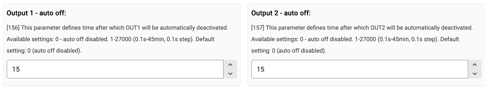

@bcopeland I can confirm, relays arent triggering, and inputs are registering under ZWJS. I switched to your updated driver for all my testing, and under the Legacy ZW stack, your new auto-off feature works perfectly (thank you :pray: ).

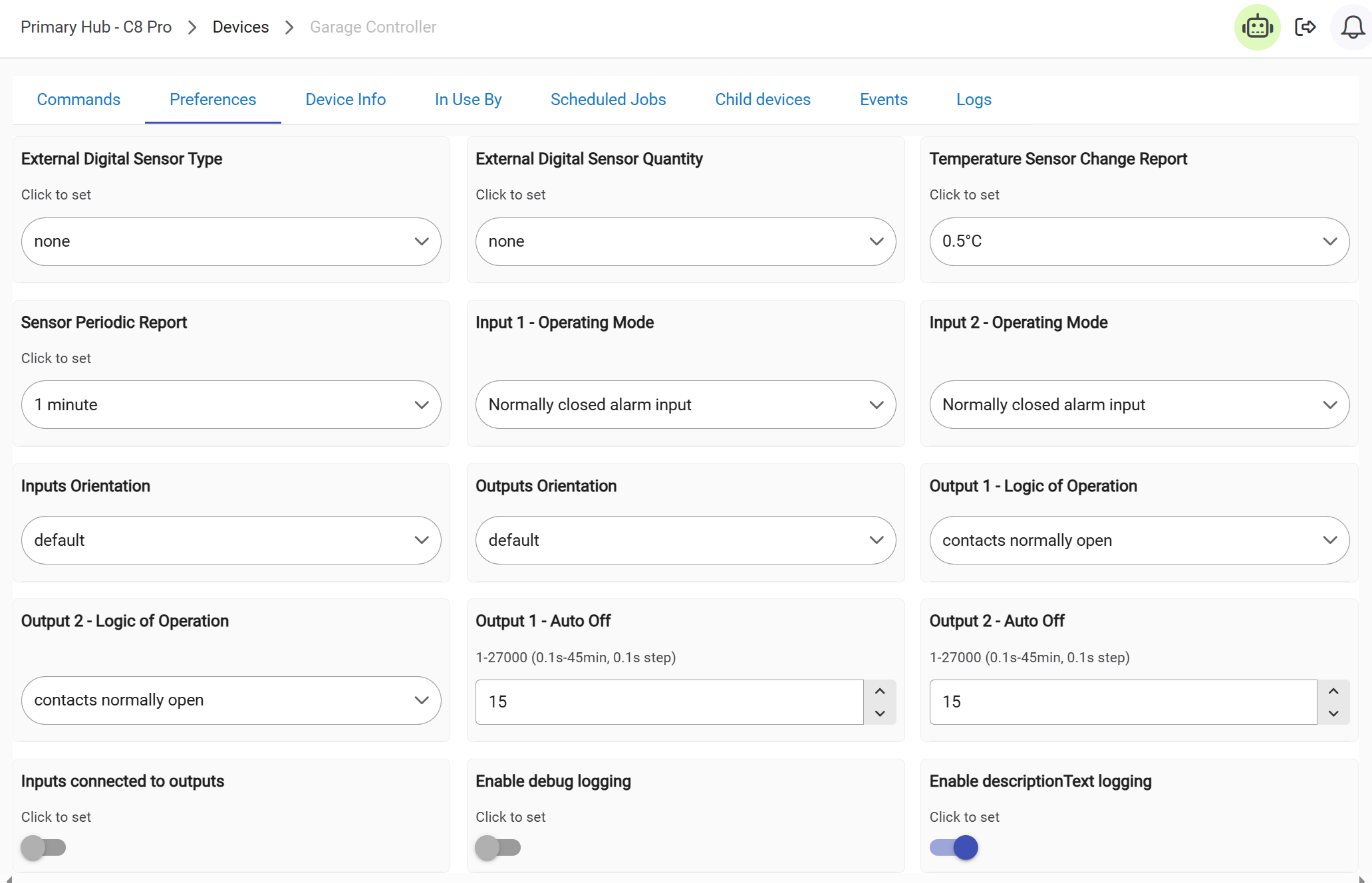

Under ZWJS, as mentioned, inputs and relays dont work - this is my config (config was the same across both ZW stacks) and the logs:
Let me know if there is any more testing you'd like me to do.
