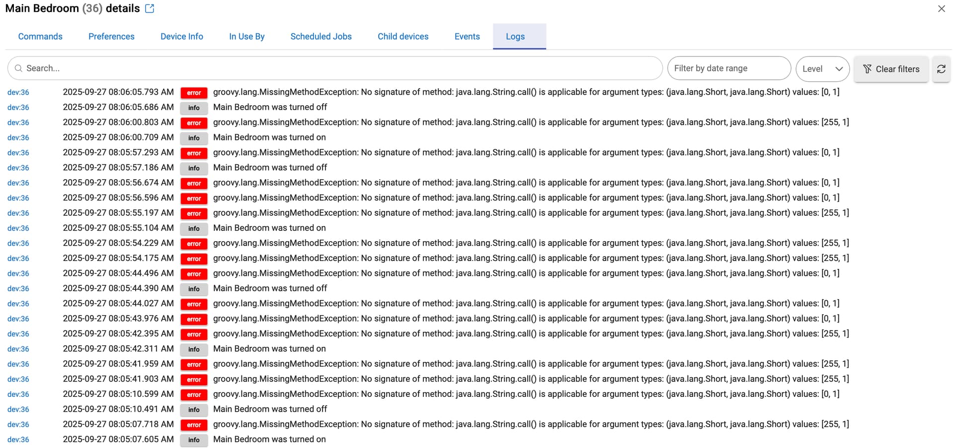

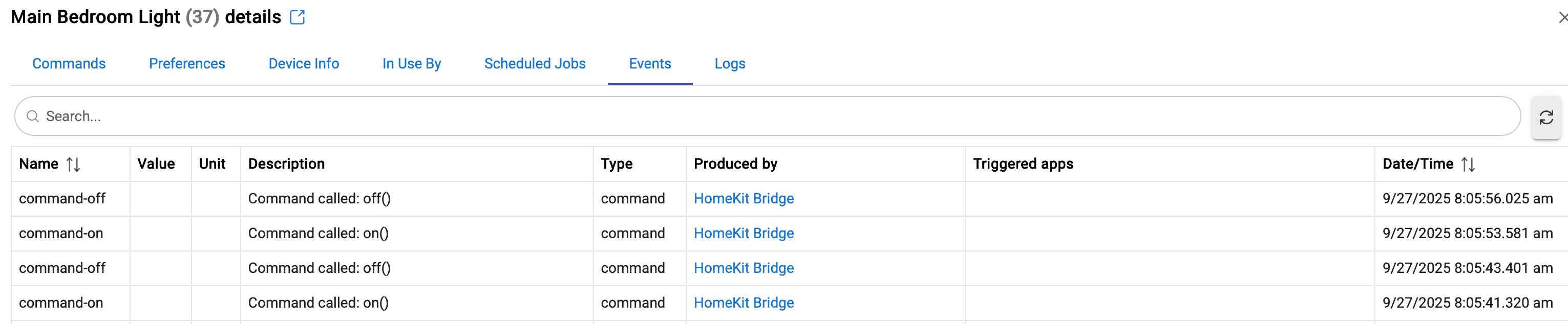

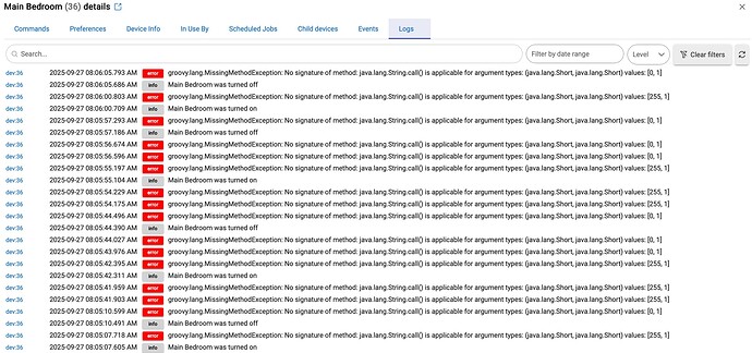

ZWJS: Aeotec Dual Nano - status doesn’t update
Hi @bcopeland the other device I’ve found that has issues via ZWJS is the Aeotec Dual Nano (there are no issues with single or dimmer variants that I’ve seen).
The switches work, but the status doesn’t update and gets out of sync, especially when switches are operated manually.
@bcopeland I just tried ZWJS again and this issue is still present - I turned on debug logging, however the results were useless. The physical button presses simply dont register until you press refresh (which I assume polls the device).
I grabbed the zwave logs tho, maybe they'll be useful - the test node is Number 14 (Main Bedroom).

However I am now seeing a ton of errors in the parent device logs:
I can confirm this is fixed in 2.4.3.127
