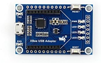

What are you using to plug this board into to give you the USB connection?

This is the most problem-free development board. It's the one I have too. Purchased mine from Digikey.
I was going to use one of these:
That's a great price. Has a coupon right now, and @Cobra confirms this works. @vjv, and @eibyer also have that one.
That's the one I've got. Works great.

Neat, I wasn't sure what worked besides the Grove Board for "development" (mostly providing a reset button so you don't need to manually short two pins yourself), but I'm glad people have confirmed that the above board provides all you need!
A couple people above also mentioned this $7 board, which I've found works well for just "using" the device after you've configured it. It lacks a reset button but can be used for anything else (hooking up to a computer for mapping or just connected to a power source for routing and whatnot): https://www.amazon.com/gp/product/B00UBFM03Y/
It's a lot smaller than the Grove board and also a lot cheaper, though so is the above. But if you want something even cheaper, something like this would definitely work if you have multiple XBee modules and want to use just one "expensive" board to program and then something cheaper for regular use of them.
Isn't the reset done just by shorting the reset pin to ground?
So I've seen, but it's a lot easier for most people to just press a button instead. ![]()
What pins, the pins on the front? Because it doesn't work, but maybe you mean the pins in the xbee itself.
This is exactly what I did, I have one with reset button and 2 without reset button.
@vjv yes pin 5 (reset) and pin 10 (grnd) on the Xbee socket (not the front adapter board header) should reset the device
