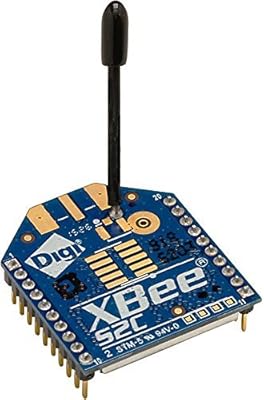

Was looking at this Xbee module. Will this work?
I do not have the older series 2 but I believe they will work fine.
you will not have the same range or the maximum number a devices to route through it and the spectrum analyzer may not work (not sure).
but for mapping and using as a basic router it should be fine.
it works, but honestly you can get the v3 cheaper or the same price.

I have the 2C and it works well, actually better than my xbee 3 pro. It seems most devices are connected to the non pro. Either it is location based (they are 10 feet from each other) or the fact that I had the non pro first and most devices choose it as a router, although I'd expect the device to choose the stronger signal?
My pro is in an old converted coal bin, with 14 inch poured concrete walls and foil insulation and now that I just said that I realize why ! Is there an emoji for " duh"?
