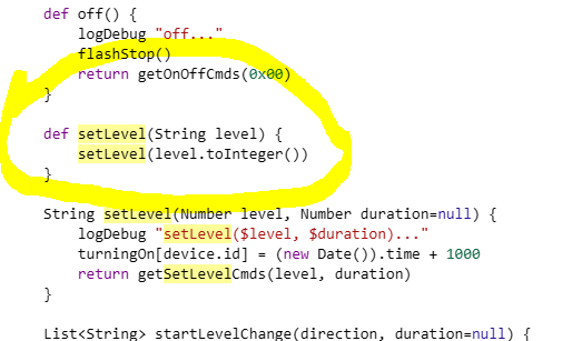

Yes, it is something HE changed in the new mobile app which broke my drivers for the level adjusting. I have not posted an update for it yet, sorry. There is a pretty simple patch someone else came up with:
Thank you!
For those who stumble upon this an are not 100% sure where to put his code in the Driver. Here is where I put it in mine and it workes just fine now:
Thanks, and it really go almost anywhere, but that would be the ideal spot for it.

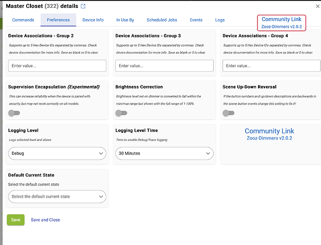

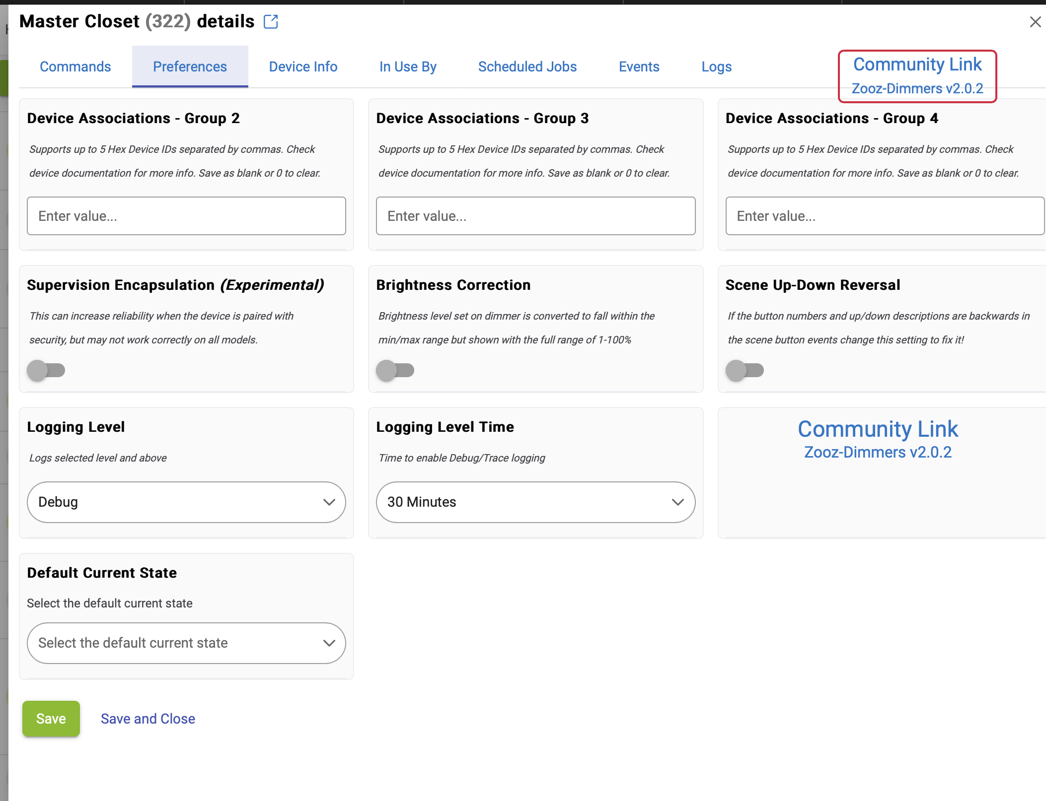

I'm only getting a few preferences showing up since updating to the new UI. Is anyone else having this problem?
Have you done a "Swap Apps" on that device at all?
Try running Configure, that makes an attempt to get any missing data back.

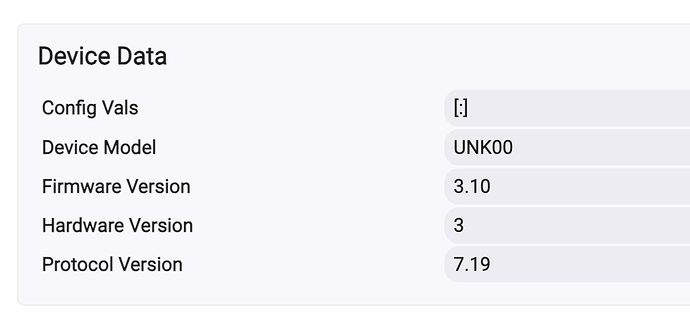

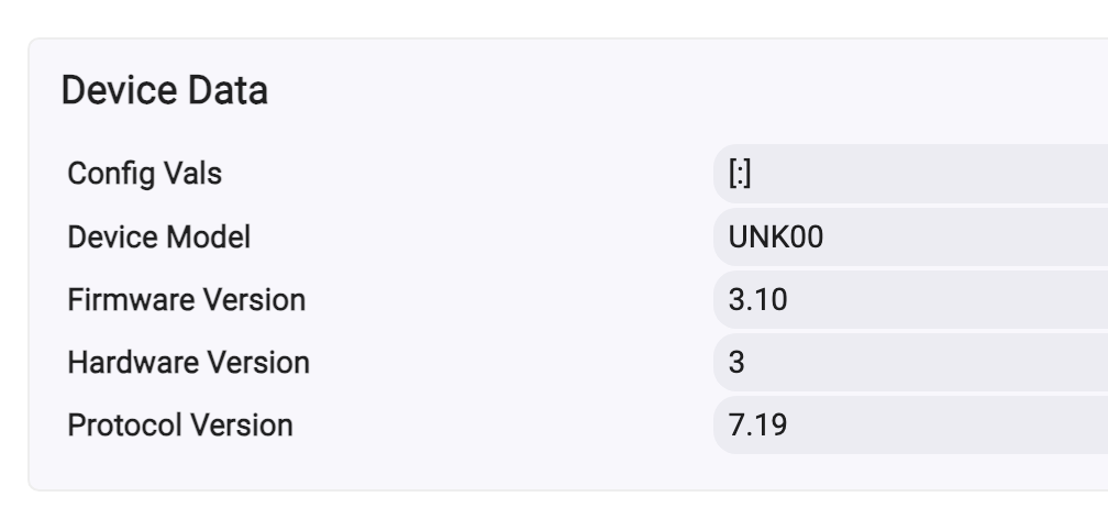

If still not working I need to see the "Data" section from the info tab, that is what the driver uses to determine what settings to show. Also would like to see the Current States.
Not sure. It's definitely possible I did that at some point.
Yeah you are missing the hardware details for the device. It was a known bug in the swap apps a while back but it should be fixed at this point. So maybe you did a swap on it a while ago.
I checked and my switch and dimmer drivers do not have the code to get that data patched in yet. You can use this driver: [RELEASE] Z-Wave Universal Device Scanner and run the "Get Info" command. Do not need to run anything else. Refresh the page and then check the data section again, should have mfg, deviceId and deviceType. Then switch back to the dimmer driver and run configure again. That should sort it out.
