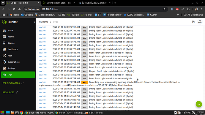

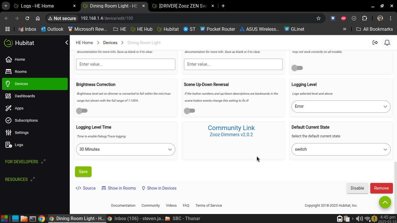

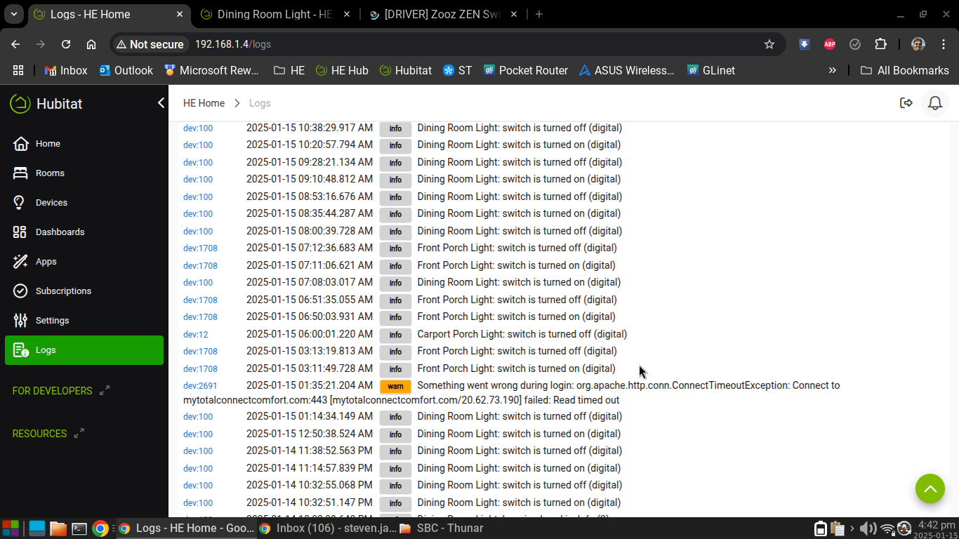

Bingo. That did it. Thanks for the quick and quality support!
This driver might have the bug that broke the error setting. Try changing it to "Warn" instead, that should get rid of the info logs. Trying to find time to get everything updated eventually... I think every driver needs updates at this point.
Thanks for the heads up. I will do that. That makes sense I didn't remember seeing the info entries before.

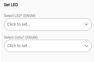

On the ZEN32 I can change the LED settings in RM using:
setLED(1, 'green', 30) on Scene - Office
Where 1 is the button/LED that needs to be changed, then color and level. How would that be done on the ZEN30 for the dimmer and the relay?
For any command you can just look at the device page.
So this tells me it take two parameters. Both are required (*) and Strings (ENUM is a list of strings in this case).
If you open the drop down menus it will show you the values you can send.
I do not have the brightness as part of the setLED on my driver.

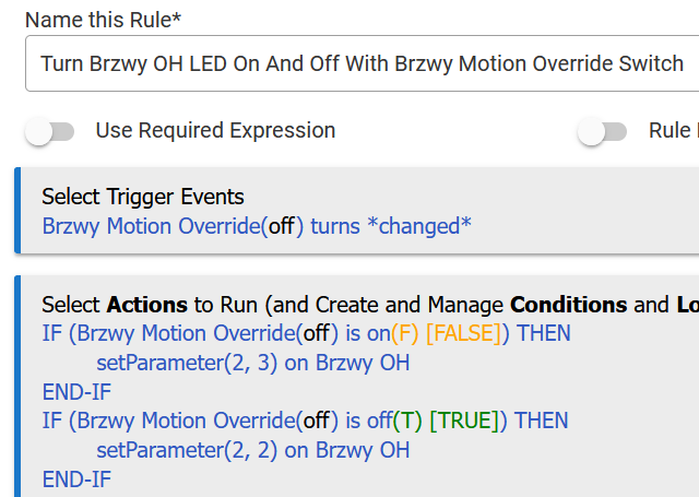

I don't have a ZEN32, but on my ZEN73 I change parameters on the fly using RM and Jeff's driver for switches:
Perfect. Either of these should work then:
setLED(Dimmer, Green)
setLED(Relay, Blue)
setParameter(3, 2)
setParameter(4, 1)
Interesting.
I just took a look at my switch's driver.
There is a setLED custom command too.
I just didn't think of using it, lol.
The setParameter command has been working well.
Brightness is in the parameters section of your driver.

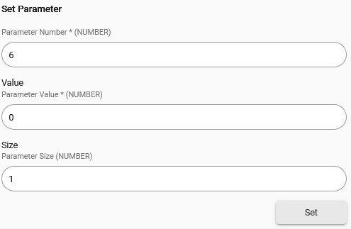

When pushing set results in this log:
I think this is due to a breaking change with the new UI...
You can insert one line of code in that function which should fix it for now. I really need to get some updates pushed out. My process is slow unfortunately.
Anyway, add this line at the top of the function so it looks like this when done:
String setParameter(paramNum, value, size = null) {
paramNum = safeToInt(paramNum)
Map param = getParam(paramNum)
Problem is that it used to come across as an integer already but now it is coming in as a BigDecimal so I have to convert it so it works in the next function being called (line 676).
That fixed it
