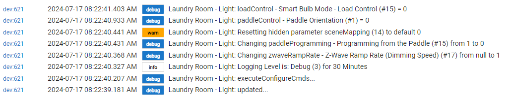

I replaced a Zen26 with a Zen77 using the zwave replace option in zwave settings. It seems to be working fine. I changed the driver to the Dimmer one from the Switch driver. My motion based automation is working. I can ask Google to turn the light on and off fine and it works.
But even though I have the logging dropdown set to Info, nothing shows in the log. It also shows 2 pending changes. The device state doesn't update, but if I click refresh it will. Also, the on and off buttons on the device page do not work to turn the device on and off.
I've hit configure several times. I changed some settings and hit configure and the settings seem to have changed (had to do with ramp rate so very easy to verify).
Show me the data section at the bottom.
Also, try to turn on debug logging, and then click save. It should try to sync whatever changes it has an issue with and the debug logs should tell me what those settings are.

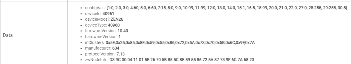

I had already tried rebooting both. Here is what was showing in the data section

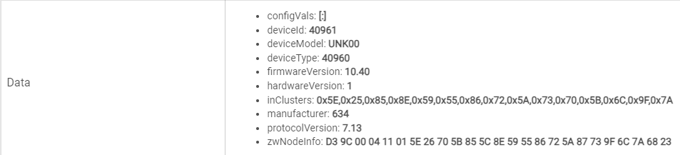

I switched to the device driver and cleared the all the state variables. After switching back and running configure I don't get very many parameters to set. My data section looks like this now.

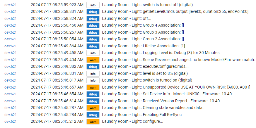

And this was what the log showed.
EDIT: The firmware version is correct. 10.4 is what I updated the Zen77 to before installing it. This is a V1 switch. I think it is still seeing the switch as a Zen26 with the 10.4 firmware, which is a combo that doesn't exist and therefore unknown. The deviceType for a Zen77 (Most of my switches are this) should be 28672. I only have a single Zen26 left, but its deviceType is also 40960.
Yeah that's the issue, switch to my Z-Wave Scanner and run the Get Info command. That should fix the device IDs. [RELEASE] Z-Wave Universal Device Scanner
*Actually, I think my latest Zooz Dimmer driver should also fix the device IDs by itself when you run a configure but maybe its not triggering due to the pending changes issue.
Then switch back to the dimmer driver and refresh, then configure.
The only thing I cannot yet have it fix is the inClusters but I don't use those directly in my drivers so even if incorrect it should not be a problem.
