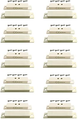

I originally thought to use two contact sensors per garage door as well... but it was much simpler to use only one sensor, positioned to indicate the garage door is closed. I have had zero false readings using inexpensive, wired, magnetic reeds switches from Amazon.
These are what I bought back in 2014...
I actually use old hard drive magnets attached to my garage doors to activate these switches. The range is really good.
I have those too but when they get dislodged (happened a few times) it would be alot better to have a second failsafe sensor. At this point I think I am just going to add the second sensor and set it as a separate tile.
You have to consider if you have two sensors, would you consider the door open if either sensor was tripped or only if both were? If you're having trouble with your sensor falling off, I would attach it better. I attached mine to the top of the door and the surface above the door's opening inside the garage. This seemed to be the place that got me the best placement that didn't have any metal wheels sliding by to knock anything off. I use these sensors and like them a lot. If you use them anywhere else, the cover hides the screws for mounting and the wire attachments, making it a little "cleaner" looking.
