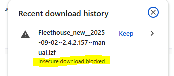

Shoot, same issue here and chrome blocked my backup, didn't notice it did that before upgrading, boo. My wall-mounted tablets are dead in the water for now. Note to self and others - beware of this alert when downloading backups:
EDIT: I literally had no idea until just now that the device self-performed backups, and I had one stored on the device. Sweet! I'm back up!
You should just be able to select "Keep" in that popup, and then you'll have the file. (Of course, this might depend on how long ago it was and whether you or it have done anything with the temporary file since...)
But in the context of this conversation, it sounds like you might be barking up the wrong tree. Your hub database backups do not include the platform version. You would need to use the Diagnostic Tool to revert to a previous version, as noted in the Settings > Backup and Restore page you probably used to get here. If restoring a regular hub backup helped with your problem, I suspect it related to one of the other solutions above (such as a full refresh of the page, or enabling one of the options).

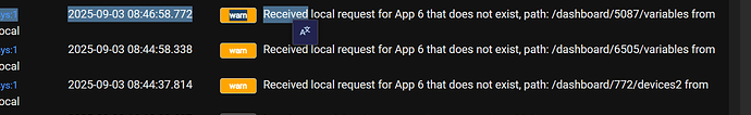

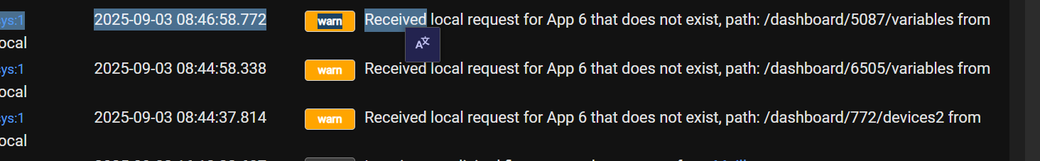

Updated to 2.4.2.158 on my C-4, dashboards working with errors:
  1. Back buttons fail to return to prior dashboard
  2. Getting errors in log
    The errors seem to be independent and unrelated to each other

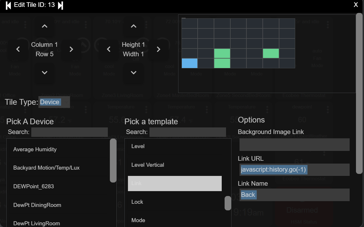

All my "Back" dashboard buttons fail in 2.4.2.158 and reload the current dashboard versus the prior dashboard that loaded the current dashboard.
Are there any plans to support a Javascript Link in the (original) Dashboards app that works with 2.4.2.143?
Dashboard "Pick a Template": Link
Link Url: javascript:history.go(-1)
Link Name: Back
Let me check that.
Checking dashboard loading times, too.
There is a quick redirect happening on the page that gets loaded first. Can you change javascript:history.go(-1) to javascript:history.go(-2) and see if that works?
Interestingly enough, javascript:history.go(-1) works for me in Chrome, FireFox, and Safari, on both cloud and local dashboards. I can see the quick page load and redirect happening.

Set the link to javascript:history.go(-2) and the Fully Kiosk Browser works as expected, but Vivaldi/Win11 fails going back to the page before the prior dashboard.
