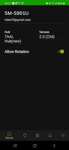

Dashboard issue with Android 2.0 app
Recently had a platform update. So i went ahead and updated
Now my dashboards wont showup and i get an error on the app.
I can remotely login to the hub and see my dashboards going that route.
S22 Android

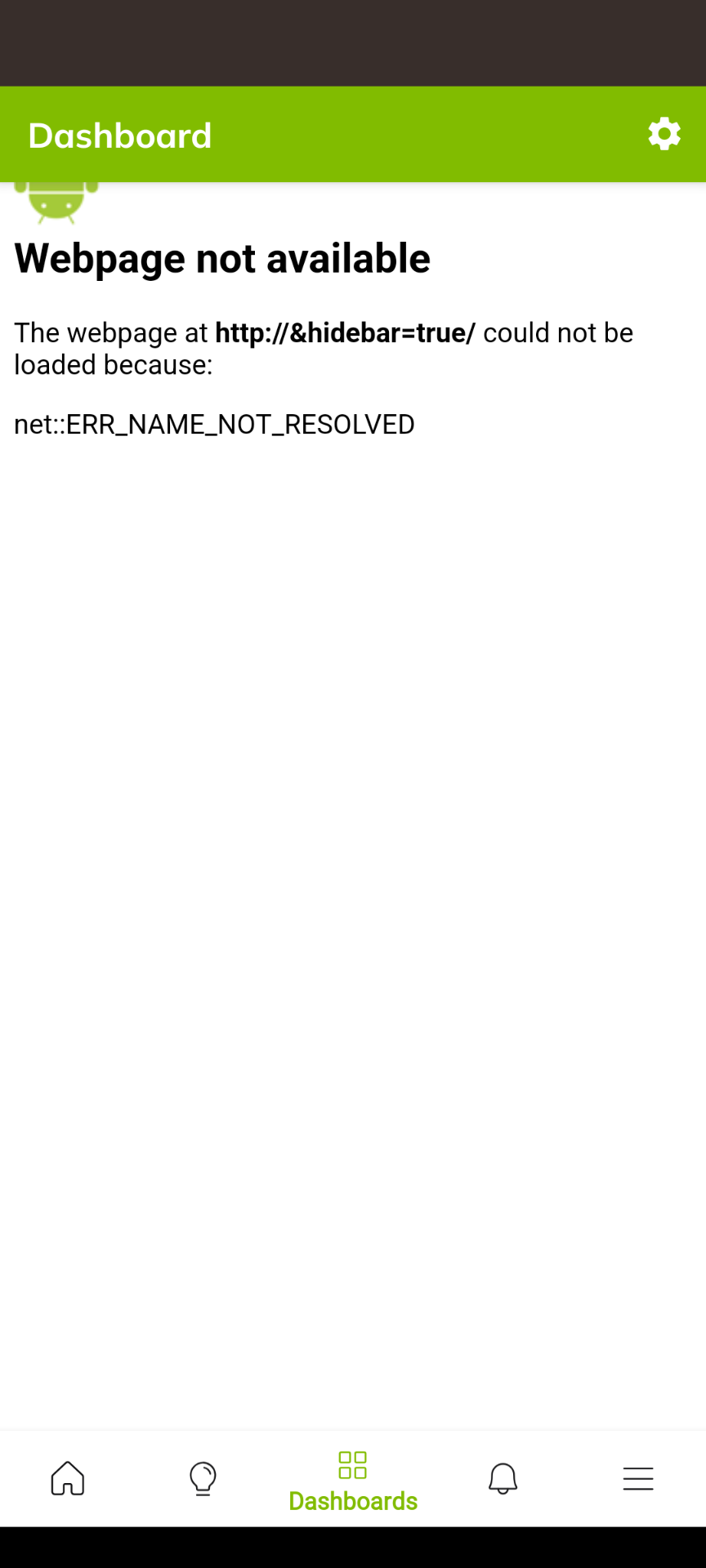

I have the same display as @jb1:
Webpage not available
The webpage at http://&hidebar=true/ could not be loaded because:
net::ERR_NAME_NOT_RESOLVED
I have the Hubitat Dashboard app installed and I can access and use a dashboard from the webpage in a browser. My wife's phone can access the dashboard from the Hubitat app no problem, but I've never been able to. Wondering if I should uninstall the Hubitat app and re-install it.
Ok, uninstalling and re-installing fixed it.
