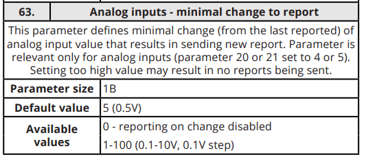

What is the voltage resolution?
Just volts, or down to tenths or hundredth of a volt?
According to the manual...

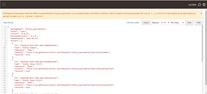

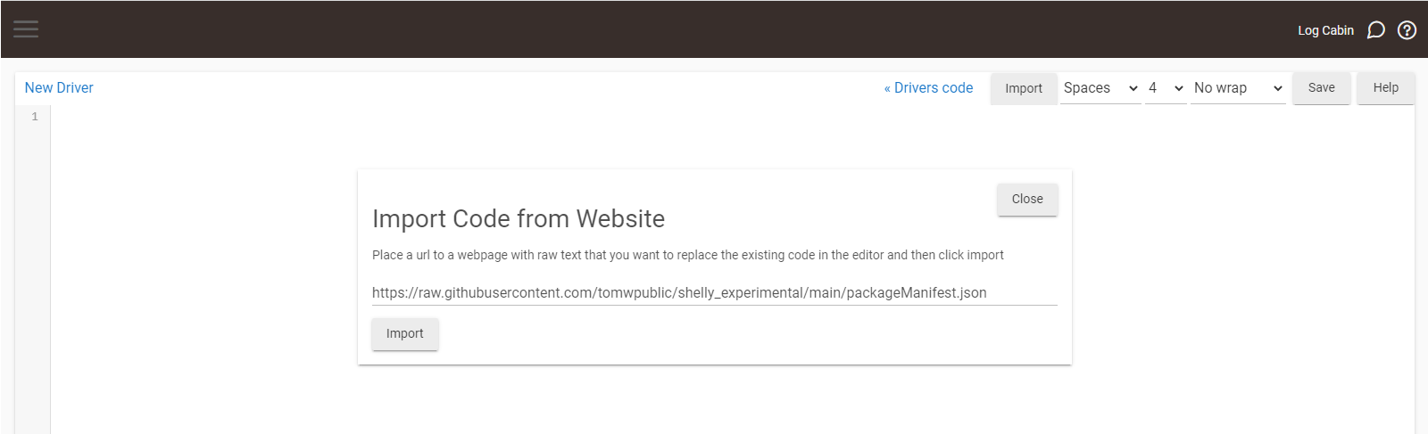

Errors when loading files from URL often result in loading a driver in the Apps area or an app code in the driver area. I’ve had this happen a lot - less now, but still does on occasion! :slight_smile:
For Shelly Uni, it is a driver (not an app). Can you share a screenshot of the error you are getting if this was not the cause?

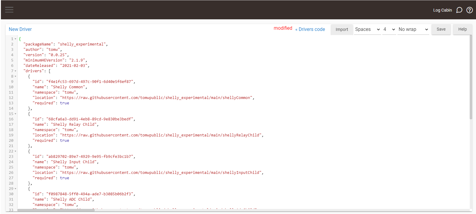

I clicked on drivers code, then put in URL: https://raw.githubusercontent.com/tomwpublic/shelly_experimental/main/packageManifest.json
The window showed this then I clicked Save
Then this error was listed and nothing appeared installed

Ah yes, this one is different. If I recall correctly, @tomw’s link needs to be added to the Hubitat Package Manager (HPM).
If you aren’t familiar with HPM, it is a community app that was built to help people find and install apps and drivers. Here is a link to it:
So step 1 is to install HPM using the link (and instructions) above.
Then step 2 is to use the URL within the HPM app - there is a section to enter a custom repository.
