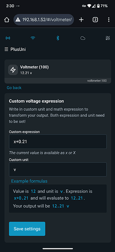

Finding the voltage is off by -0.24 volts compared to 2 voltmeters.
Any way to adjust?

Yes the voltage difference is there at a lower voltage too. At 7 volts it off by .17
Let me look at something. I think you might be able to massage the voltage. Mine was spot on so I didn't have to. It will be a bit as the vehicle with the Uni isn't here right now
If not you could easily do it within a rule in RM

This may be it, some testing to do here :grin:
Edit: Appears to do the trick :tada:
Not sure if that is correct for my data input, but it's working :rofl:
Can I make a suggestion. I'm assuming the .24 was at 12V and you said the .17 was at 7V.
If that's the case, then you are off by about 2%. You could use X + (X * .02) and I think that would get you closer through the entire range. If that is important to you.
You could play with the .02 to try and get even closer if you wanted
The second UNI I received was closer on the voltage with a 0.81 % calibrator
X + (X * .0081)
Guess I will use that one....
