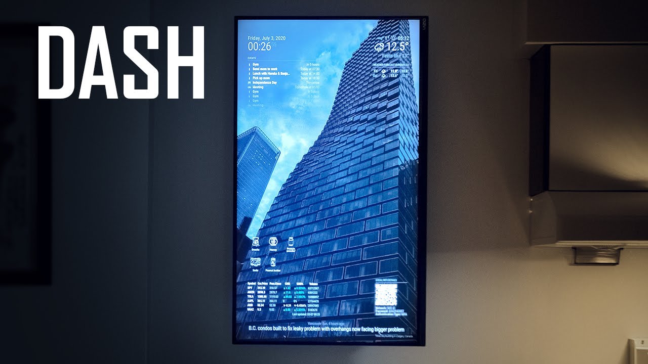

A smart mirror with touch running Magic Mirror, then customized with some CSS and HE maker output could solve this, but it won't be a 1 night task!
This guys Magic Mirror for example, is really nice... and there are numerous utubes vid's on the subject that might be more specific to your wants and needs.
