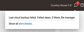

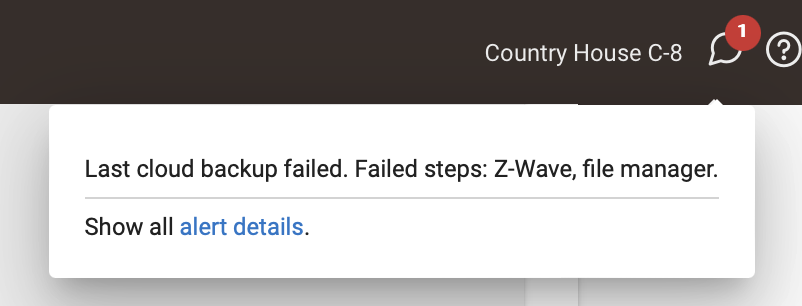

Same error as noted abovem post-cloud backup.
2.3.7.140, C-8
edit: .140 is providing more error info, anyway, which is a good thing.
edit2: A subsequent manual cloud backup was successful.

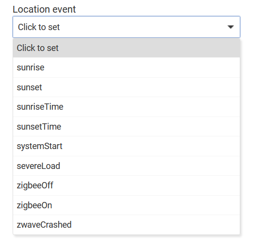

Also, @bobbyD , it would be nice if a location event was added for this situation.
zWaveCrash doesn't kick off here.
I do a test for a trigger which involves a zWave device not reporting for more than 32 minutes.
It would be nice if something more timely, and foolproof, was available.

That's because it hasn't officially crashed yet, as far as the radio knows.
How long does that usually take?
I think I had to do the rule because zwaveCrash didn't kick off in this scenario, Zwave failure after cloud backup.
Just speculation, but think that the destinction is that when the backup fails the Zwave is briefly off and doesn’t turn back on.
Yet, there are location events for both zigbeeOn and zigbeeOff, and only for zwaveCrashed, which is less than responsive, and I would say, maybe even unresponsive, in this situtation.
