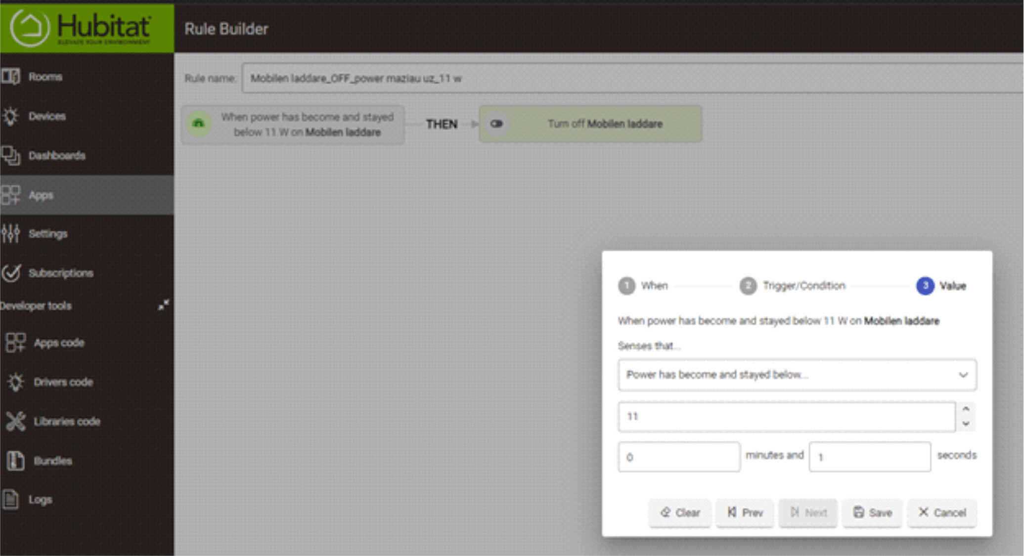

Why is it not possible to adjust the time in the Visual Rules Builder when we save and close it, after opening the time does not change, it remains 1s, although before that it was saved to 30s?
What is the device that you are trying to use with this Visual Rule?
The OP is about a Tuya mmWave sensor, these do not have power attributes ...
Everything is fine, I used another rule in Rule Machine and it works.
