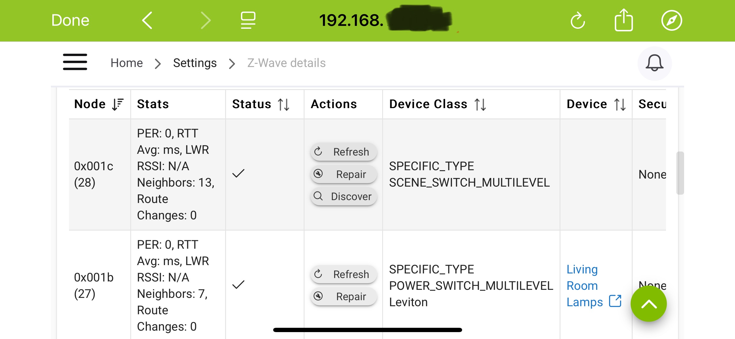

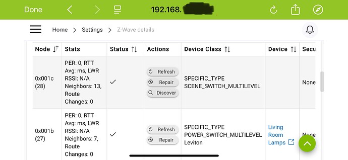

Feeling lucky, I went ahead and tried the same process with the Leviton VRP03 dimming plug module (same zwave plus module, just older version). I reset, zwave excluded, and then zwave included it using the “add manually” process. I did not get a confirmation of inclusion, however. I then can see a new device listed in the hub’s Settings>Z-wave>Maintenance device list. I am providing a screenshot here showing the the device (which I believe is the Leviton VRP03.) as well as the just added. Leviton DZPHD.
Suggestions of what to do/try now? I have “discover” and “repair” as options for the device— this is my only device in the list with the Discover option. I see it does not have a device name like all the others do.

For the VRP03 I think that is one of the very old devices that do not play nice with a C8, something with the zwave radio chip they do not like. Is that a Vizia RF device? It is most likely 300 series chip: https://products.z-wavealliance.org/products/832
Also, about your z-wave details. Any entries you have in there with no device name showing is what we would call or dead or ghost node. Sometimes on rare occasions if you click the discover button a couple times it may find the device and finish pairing but it very unlikely. How many of these ghost nodes do you have now with all the pairing attempts? Here is a guide with a lost more info: How To Remove Ghosts using hub tools or a UZB Stick

Due to the unsuccessful inclusion attempts with the VRP03, I ended up with two ghost nodes. I followed the steps in the guide you linked and after unplugging the VVRP03 I was able to eventually get to the “remove” button using the native Hubitat tools and was successful at finally ridding the network of both. How To Remove Ghosts using hub tools or a UZB Stick
